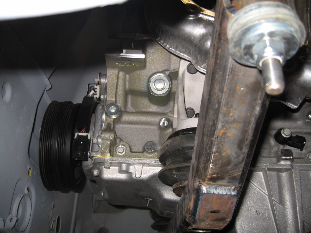

A closer view of the cross bar. The engine cross bar is bolted securely to the "frame", the motor sits on big rubber dohickys on the cross bar.

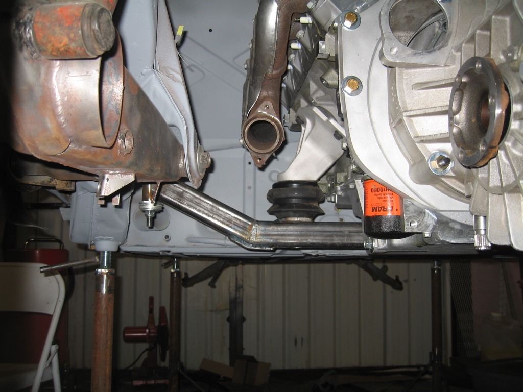

Side view. 1/2 inch of clearance in front of balancer. Sure I'll have to do a little firewall mod for room for the water pump.

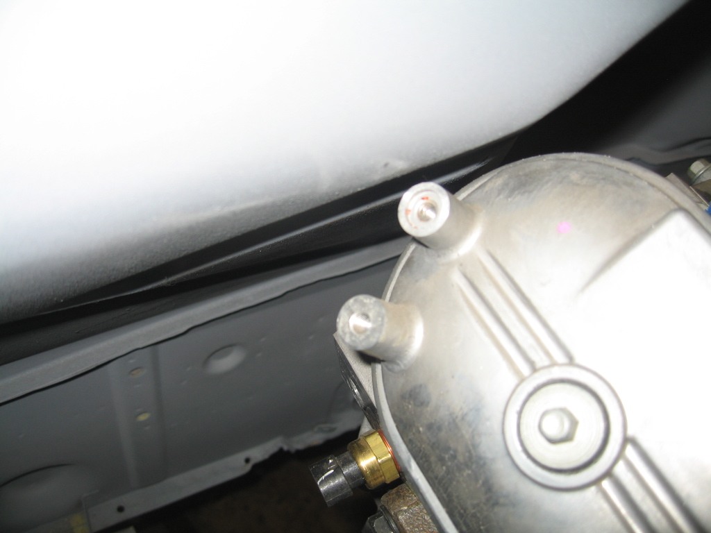

Driver side valve cover. There is a 1/4" of clearance between it and the firewall.
