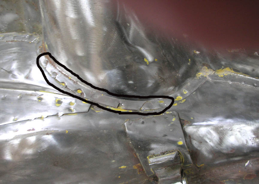

#41 was running the 2.5 SS for 30,000 miles with 7 inch BBS with Michelins. Some where in there these stress cracks appeared. There is no rust on this car in any place in the rear of this car or longs. I believe that there is a lot of stress put on this area of the car as the underside of transmission is bolted there in the center. It is like the step of a ladder. This is one of the main points of the GT kit and that is why I am putting Rick J's kit in.
With the wider wheels like I will be running and the bigger HP it is something to consider.
Bob

burton73   T.C. #41 was running the 2.5 SS for 30,000 miles ...   Jan 3 2009, 05:45 PM
carr914   I'm not sure of the exact area of the shot sin...   Jan 3 2009, 06:55 PM
burton73   T.C., I just wanted to point out that I believe t...   Jan 5 2009, 05:57 PM
