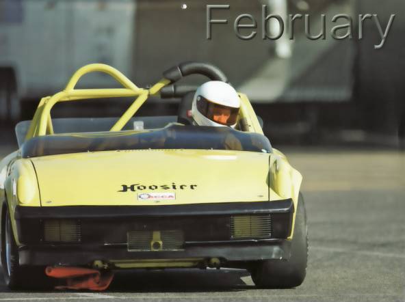

RAB914   is yellow inside ther is original?   Jan 18 2009, 03:33 PM

davep   I you are talking about the 914/4 M471, then this ...   Jan 19 2009, 03:40 PM
Gustl   I you are talking about the 914/4 M471, then this...   Jan 19 2009, 11:20 PM
sixnotfour   made from abs about 3 mm thick, had end caps glue...   Jan 19 2009, 06:39 PM
