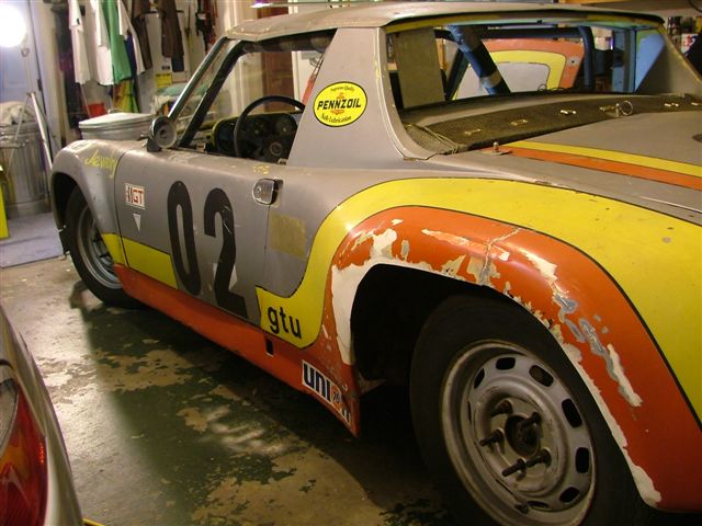

Competing at Sebring as a 4-cylinder (changed to a six soon after).

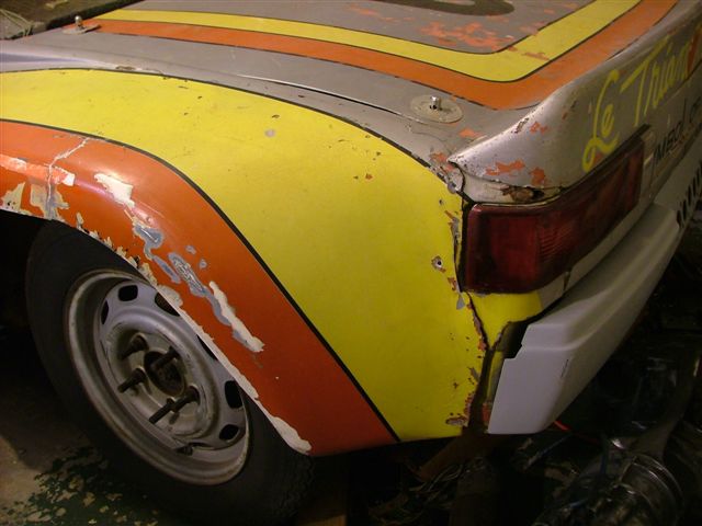

Fiberglass flares and paintwork need a little bit of work.

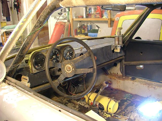

Here is the dash area. Notice the old halon fire system. I am a little nervous
about disconnecting it. I guess the worst is that it triggers and sprays halon,
which I think it pretty inert and non-staining.

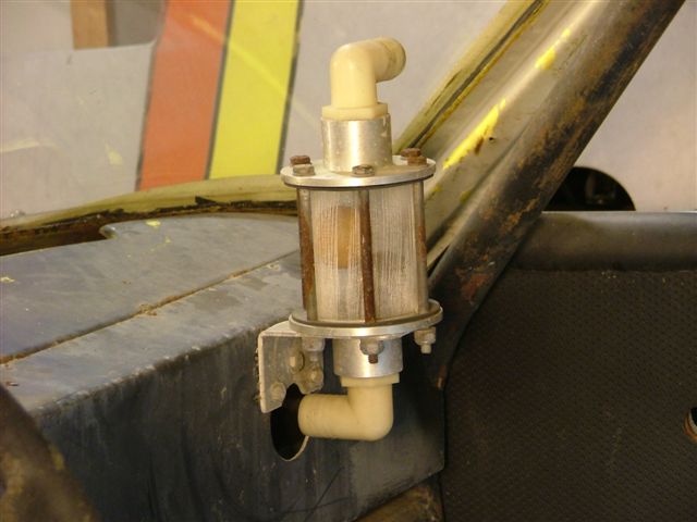

Weird roll over fuel cut off device which uses ping pong balls.

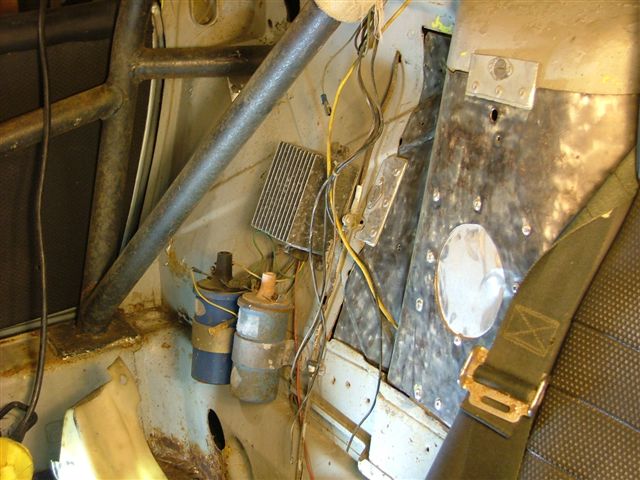

Twin coil ignition system. I'd like to run a twin plug six motor but I guess
this is much more expensive than a single plug? Also notice the dzus fastened
motor access plate in the firewall. For safety, I will either weld this back up
or install some better sealed panel.
Wide, fiberglass flares are pretty cracked and beat up. I think I will cut them
off while the car is being blasted. There is a lot of rust underneath the fiberglass.
I plan to repair the flares and reattach them once the car is expoxy primered.
I used to shape and laminate surf boards, so this should not be too hard. The
flares were rivetted and glassed originally. I think I will just glass them to
eliminate the rust holes created by the rivets.
