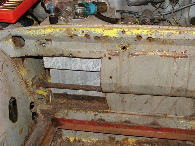

Not sure why they cut this big hole from the trunk to the gas tank area.
Don't be shy if you have any comments, people.
