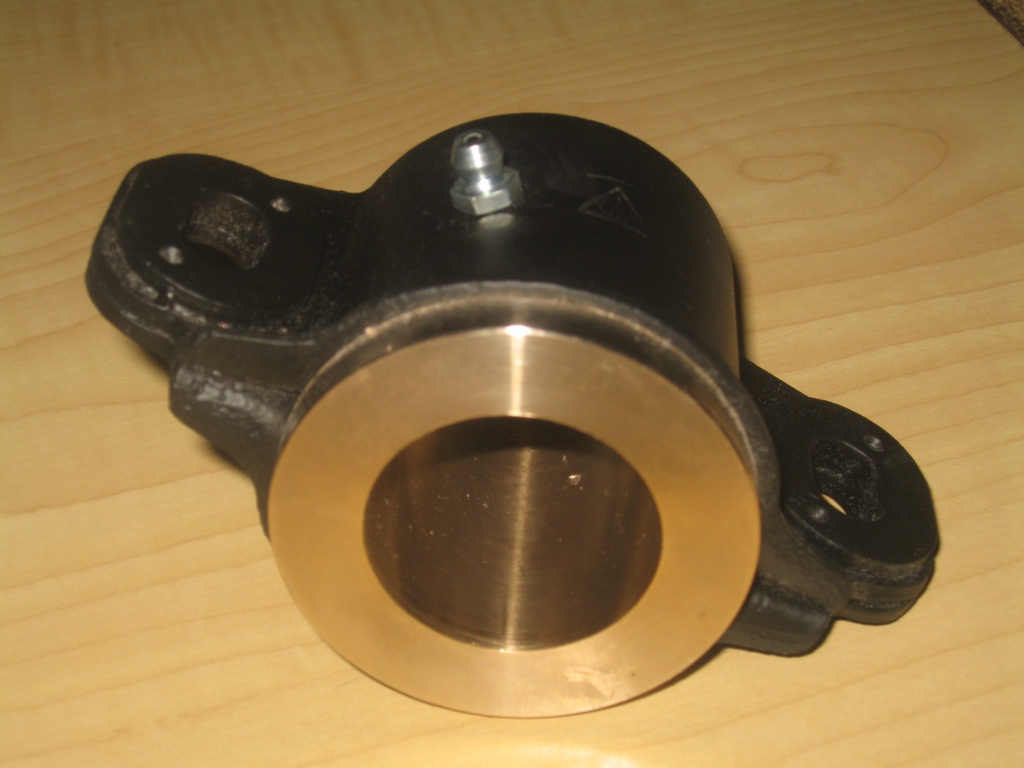

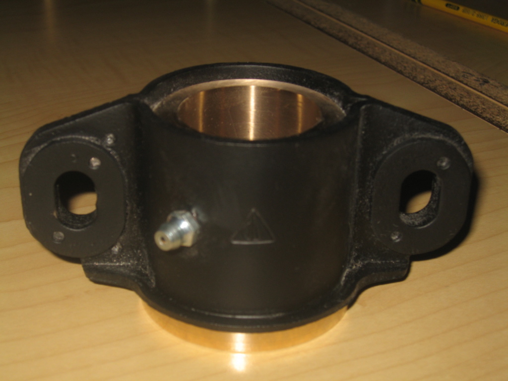

Just a little done today. Thought I would experiment with powder coating. I tried this once before when it was raining and had mixed results due to the humidity. There is snow on the ground today so I thought it would be nice and dry. First took this control arm end and sandblasted the old crud and paint off then applied the powder. I really liked the process except for the baking. I am using an old oven someone gave me and when it got up to 400 degrees the stench it put out was unbearable!!!!! A combination of rancid meat and mouse urine if my delicate senses are correct. (IMG:style_emoticons/default/icon8.gif) After this I pressed in a bronze bushing and drilled and tapped it for a zerk.
