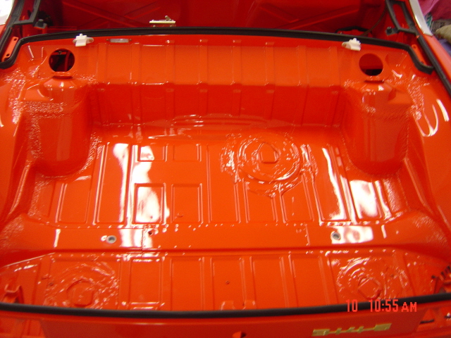

9146FAN   Trunk shot. Lot's of sanding to make it look l...   Jan 26 2009, 10:28 PM
