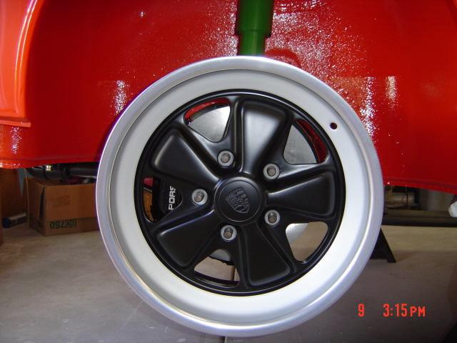

Fuchs were restored by Harvey. I asked for this finish which is slightly brighter on the lip. The rim is more frosted, and the center simi-gloss black. If I remember, Harvey said this was on original style used on 15" in mid '70's. These are 7x16.
I really like the look and just set one on the hub to see what it looks like.
Looks great to me.

This is a restored "Fuchs" wheel???
