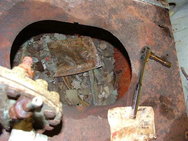

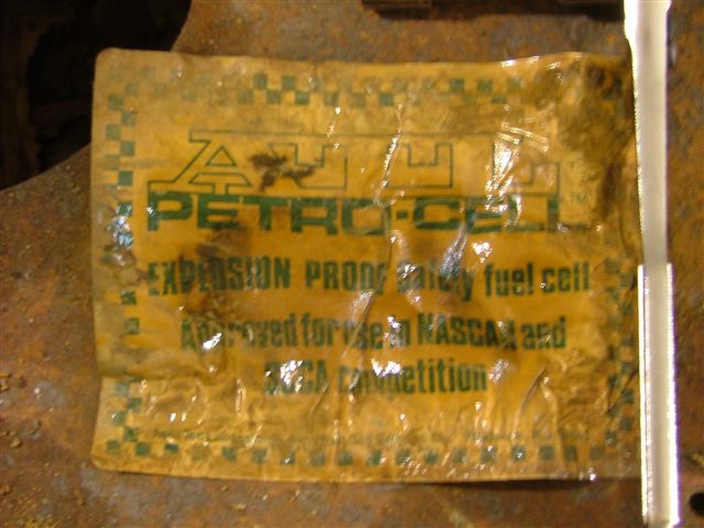

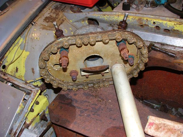

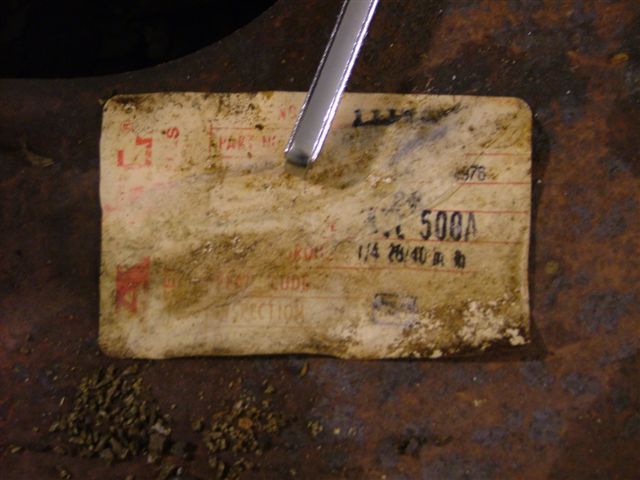

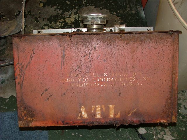

Pulled the fuel cell and checked it out. Might need some work.
The fuel cell has a very sturdy rubber bladder filled with foam in it, or maybe not.
I guess that is what 33 years of soaking in racing fuel will do to something.
Looks like it was bought in 1976 and is a 500A model.
I'm pretty sure the receipt for the cell came with the car. Do you think ATL will
honor the warranty still???

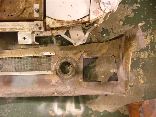

Back of the front bumper shows layers of fiberglass repairs and bondo. Sorry
about the poor photo quality. You can also see the mounting brackets for the
main head lights.
