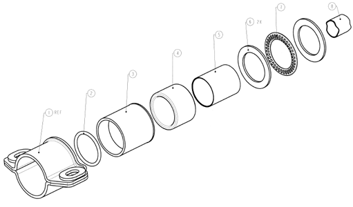

It looks like that is how its done here.....a couple sleaves an inner and outer. Are they then pressed on the shafts? for the front and the back? The other option is of course doing the polybronze setup which McMaster has as well.

QUOTE(degreeoff @ Feb 4 2009, 07:12 PM) *
That's a schematic of McMark's front roller bearings. You need two of those per A-Arm.
The rears are completely different ...
