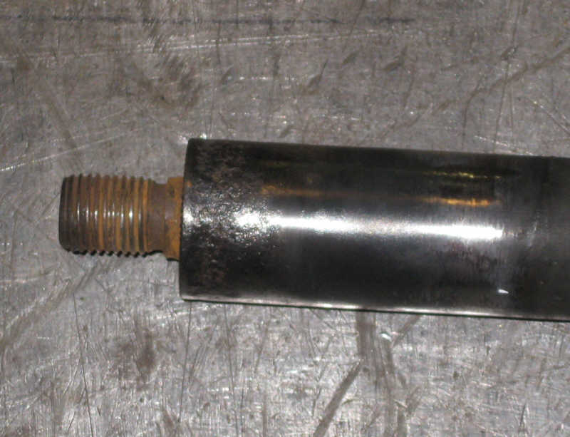

More than 50% of the trailing arm pivot shafts we remove look like this:

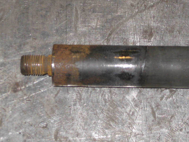

After sanding on the belt grinder it is down to the original diameter again:

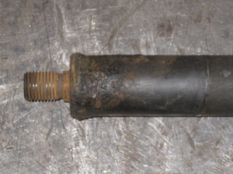

but, after wire brushing, the deep pits that remain are evident. Installing this shaft into any plastic bushing can't be good for longevity:
I was having the best shafts that I could find centerless ground for a while to true them up without removing too much material. What I found was that the shafts aren't straight enough to true them with removal of only 2 thou diameter, and if there are any pits the .002 removed doesn't get rid of them.

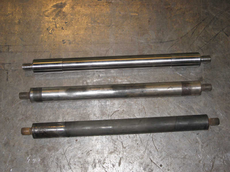

So I designed new shafts that are more precise and stronger than the originals:
