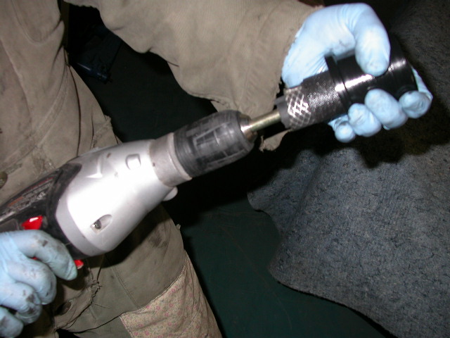

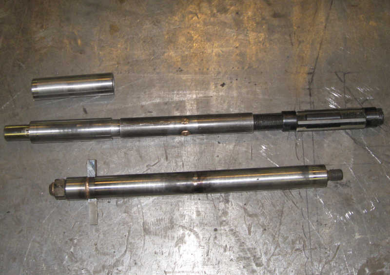

Our delrin bushings have a light press fit into the trailing arms. This means the id is no longer the correct dia or round any more so we ream them precisely using our "home-made" tools. The trailing arm bores also aren't quite straight relative to each other. Reaming or honing each one independently means they aren't going to be concentric. The id has to fit more loosely in order that the shaft doesn't bind when inserted through both ends.
This method is hardly precise, lol:
The long shaft added to our reamer allows it to align from the bushing at the other end, thereby ensuring concentricity of the two bores.
The modified pivot shaft holding the lathe tool bit is used to cut the end of the delrin bushings precisely. This ensures that the pivot shaft will be about .005" longer than the bushing end to end dimension so no side play or binding is evident after installation in the chassis.
