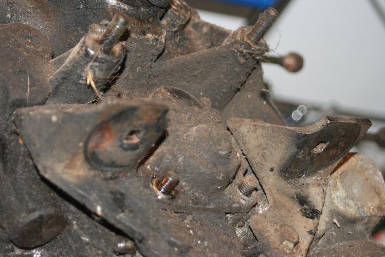

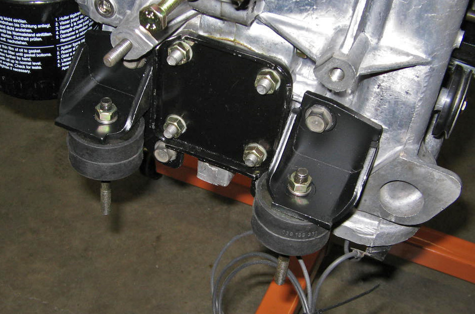

Gotta keep this thread alive... Just a tiny bit of progress tonight. New rubber engine mounts, and freshly blasted and repainted case mounts. Also new mount to case bolts. I like looking at the before and after photos.
