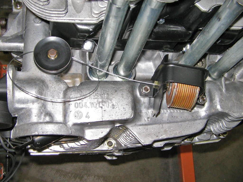

MrKona   Gotta keep this thread alive... Just a tiny bit of...   Feb 7 2009, 01:27 AM
MrKona   Also blasted and painted the thermostat mount and ...   Feb 7 2009, 01:33 AM
