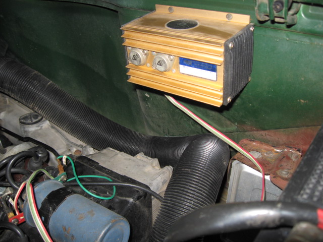

Car starts when cold (not quickly, but it does start, air temp. 80 degrees), then it is a bitch to keep it going. Once on the road and warmed up it performs beautifully.
I have checked the Aux. Air Valve and it is sucking when cold, plugged when hot.
I replaced the head temp sensor even though the old one tested OK. The new one helped a little, but not near enough.
I have studied Brad Anders' site and can't come up with any other ideas of what to check. I have to believe the ignition system is fine because it runs so well when warm. I have checked timing and dwell and they are on spec.
Any suggestions out there?

All who offered help last fall, please see my post of today, "Could this be my problem"?
Especially if you know something about old CD ignition boxes like this:
