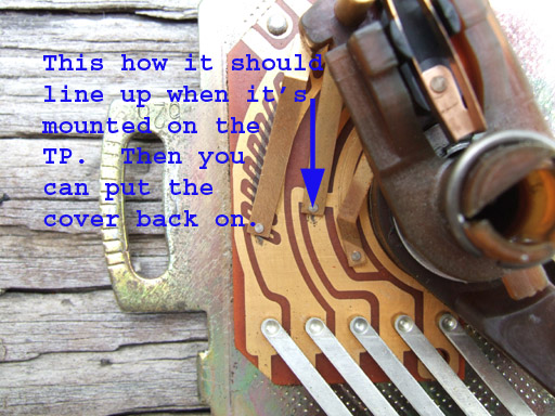

TPS pic at Idle with flapper closed on throttle body.
Take note of the middle finger/contact. This position activates the idle circuit.
This shows that the TPS cannot be adjusted...it only has one home.
The adjustment is due to different throttle bodies and physical differences from one system to the next....same part for volvo, Merc, porsche etc etc etc.
