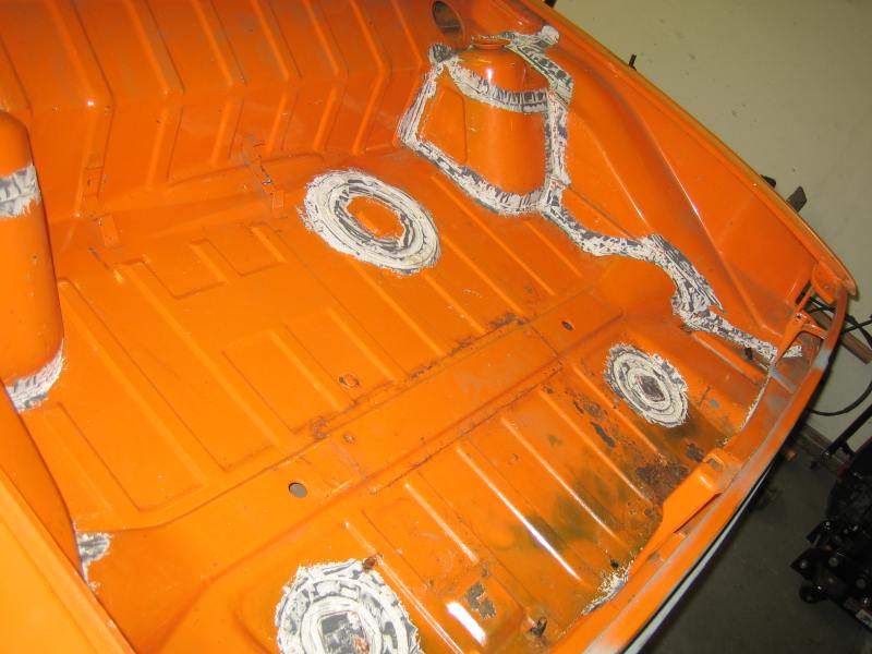

So a couple months back I posted about getting a hold of the project candidate,
feel like I have moved on from that so thought it I would post some pics on progress and I will add to this thread as time (and progress) goes on.
I did not get around to stripping the car down till earlier in the month as I drove my 928 down to Sharktoberfest in LA and I was performing last minute tinkering before the drive.
Anyway back to 914 subject matter, the good news is I have not found too many issues which is a relief and I can start to order parts and make some investment in tools. It is a perfect time of year for indoor projects as it is below freezing all the time now and skiing does not start here till after xmas.
Surface rust and dirt in the front trunk but that is about it, will need to repiar a couple of areas around the hood seal.
Chris

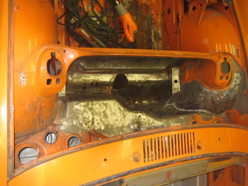

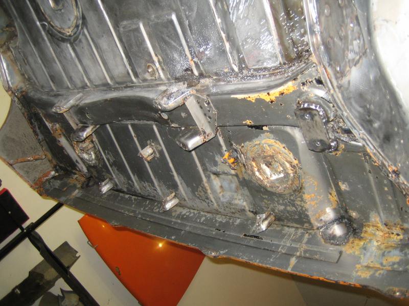

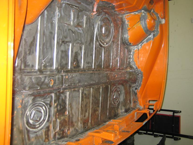

Another long break but work has been progressing, sometimes prepping areas of the car takes a while.
I finally removed most of the underseal and primer from the rear underside, I drilled out the spot welds for the heat shield and am glad I removed it. There was some surface rust under there and needless to say the area was devoid of underseal. Still needs a final going over but 99% there.

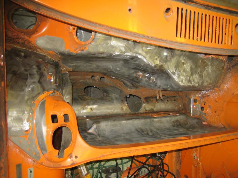

Next I attacked the trunk area, rust looked much worse once I got rid of the paint but no holes so that is good. Interesting that paint is much harder to strip and remove when it is covering corroded metal.
Next onto the front and under the fuel tank, it is a bear to clean that area up and been through most of my tool kit to get it like you see below. First pic shows the corrosion after paint stripper and the second pic is after wire wheels and abrasives.
