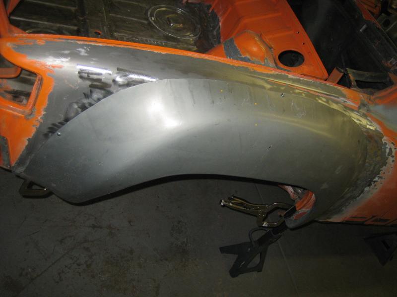

So this week I decided to attach the flares as I now hvae the GT rockers, started on the passenger side front as I figured that the second side would inevitably be an improvement over the first. That way every time I walk up to the drivers door I will see less mistakes ... well that is the hope.
There are plenty of other threads with more talented individuals showing how to put the flares on so I will spare you the amatuerism. To get the flares snug before major cutting I removed slots on either side so the bottoms of the flare would slide in. Second pic is bit blurry but you get the idea.
Then I got the jig saw out and started to tack weld, my mistake on the first one was to align both bottom edges and then work my way up either side so the top was the last. Big mistake, don't anyone else do that. I made it work and in the end I am sure no-one will ever know but I created some work for myself.
Here is the passenger side front tacked.

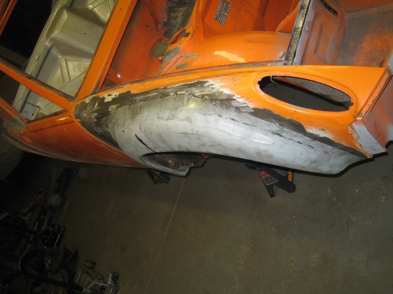

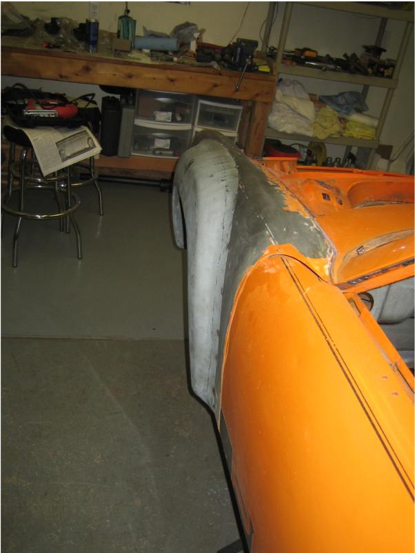

Drivers front is much better, right now I am just tack welding them all on and will do the finish later. I found that 2 hours at a time was just about right to avoid getting frustrated and just taking my time.
I now have the passenger rear mounted and ready to be completed tomorrow.
I also found out that the drives side rocker is over 1/2" shorter than the passenger side so that will need some modification in the future.

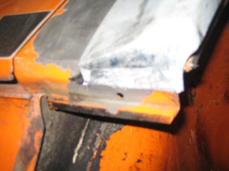

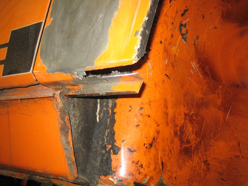

my928s4   OK got a couple of hours in yesterday and today wi...   Dec 30 2007, 02:30 PM
my928s4   The bad The good   Dec 30 2007, 02:35 PM
my928s4   Messed up.   Dec 30 2007, 02:37 PM
scotty b   rear pan section is definitely needed. IMHO that s...   Dec 30 2007, 05:18 PM
