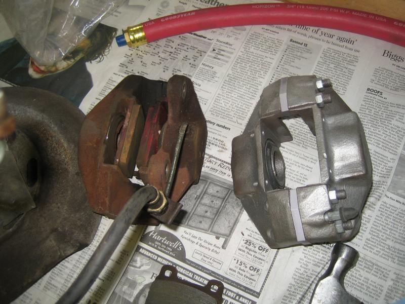

I bought a HF blasting cabinet and have been cleaning up all kinds of stuff.
Above shows an 'M' caliper before and after, I also cleaned up the a-arms and have those and the x-member at the powder coaters.
I also procurred some late rear calipers and SC hubs.
Fingers crossed I may have some 3.5" struts in the next few weeks.
