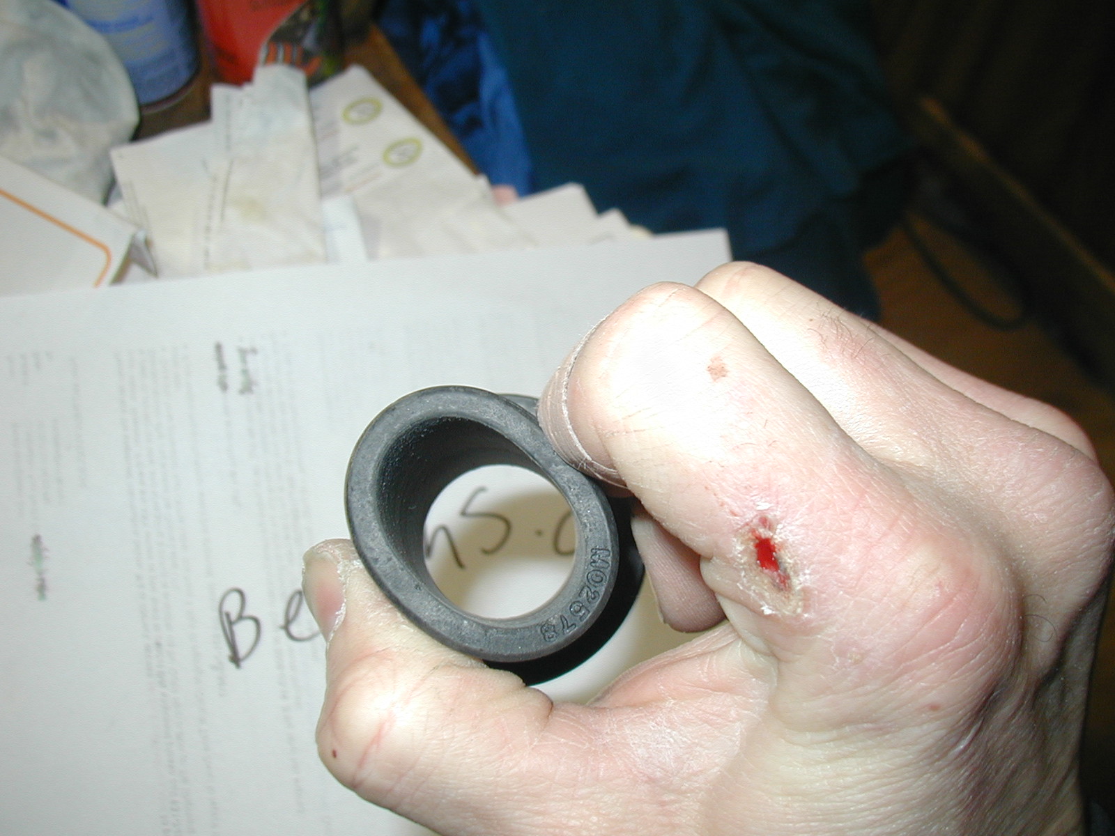

Attached ImageSo this is a picture of the bushing i purchased over a year ago, what do you think are they the soft or hard bushings. This was the most i could bend it before eating my spinach either way it might pay to get the ones PMB are selling for $20.
Thanks
Matt

Eric_Shea   Pretty obvious. ;) That's a perfect example ...   Feb 9 2009, 04:53 PM
