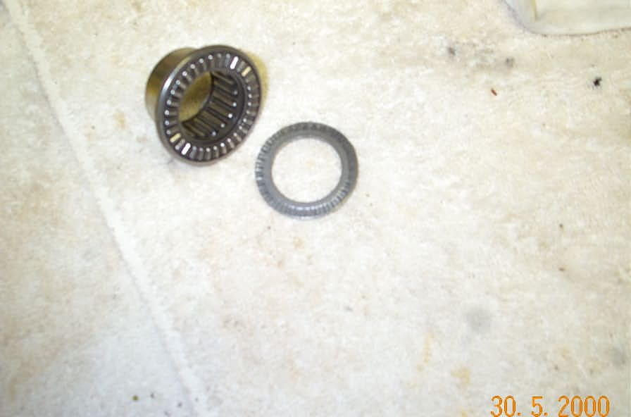

Swing is a foregone conclusion, but is there any slop....lateral or axial.
My needles are still tight but wear was evident on the thrust washers.
I turned them over.
BTW, Rich, I had the tranny down & found a broken needle bearing cage under first gear. The needle was still in place but the cage was cracked thru side to side. That coulda got ugly.
