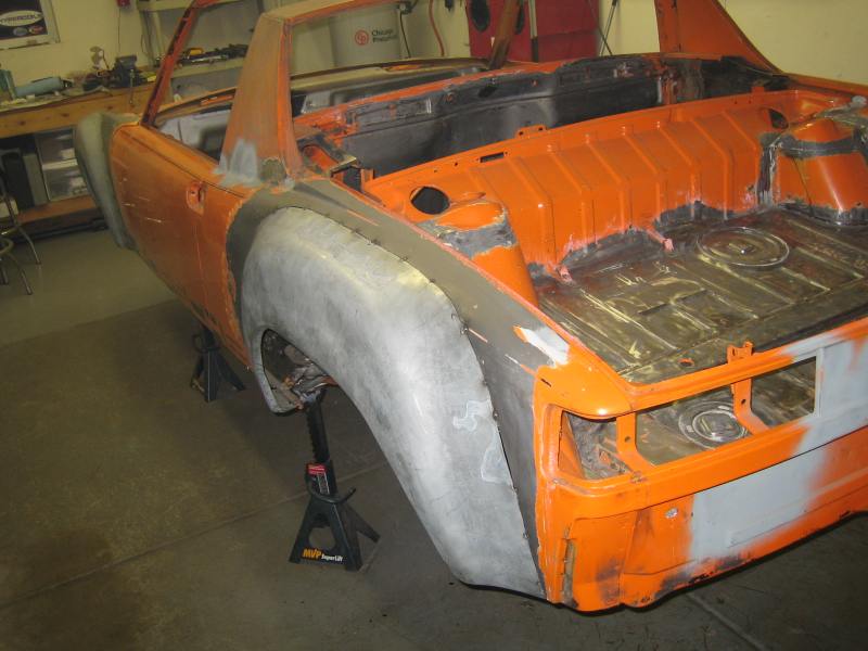

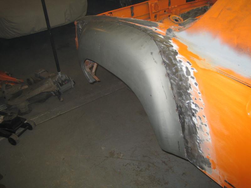

OK, finished tack welding the rear flares.

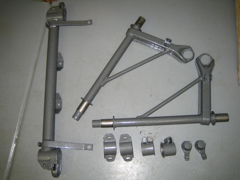

Got my powder coated front parts back, makes a change to see some nice shiny parts for sure !! Makes you think this thing might go back together at some point.

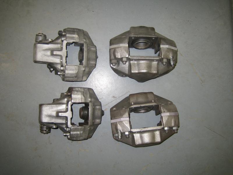

Calipers are ready for disassembly and some plating, I think I have enough parts to make it worth a visit to the platers now.
OK, now to some hammer and dolly work and finish welding on the flares.

my928s4   Got some parts plated, calipers came out crap so a...   Mar 15 2009, 01:13 PM
my928s4   Still working on the fenders, got the third (passe...   Mar 15 2009, 01:17 PM
