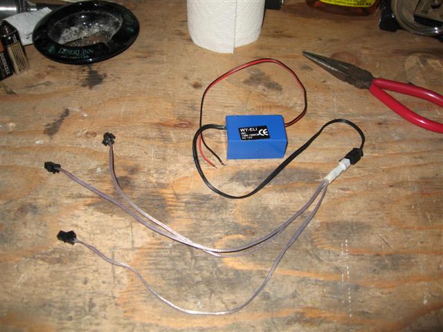

Porsche Gauge illumination upgrade/modification.
For this write up I’ve used a 914 Tachometer, but the method is similar for other Porsche VDO gauges.
Pointers appear dim, but this is a short coming of my camera.
In real life pointers are easy to see.
Tools you will need:
Small flat screwdriver
Scissors
Soldering Iron
Wire stripper
Crimp tool
Parts you will need:
2 wire connectors
wire
Small diameter heat shrink tubing
Clear packaging plastic(saved from trash)
Scotch tape
solder
5 feet of Electro Luminesent wire
12v inverter for above wire

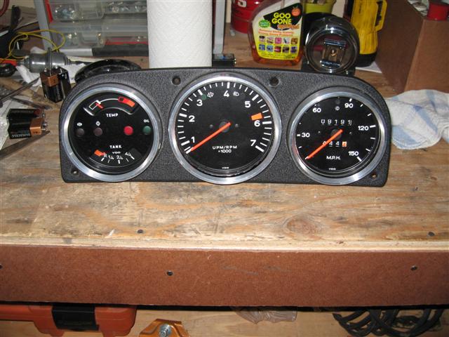

Gauge Dis-assembly:
First thing is to open up the gauge. This is done by prying at the bezel with a small screwdriver. Work around ¾ of the circumference of the gauge. It should be possible to remove the front trim bezel holding the lens in place. Beneath the lens is one or two additional bezel trim pieces (depending upon year of gauge).

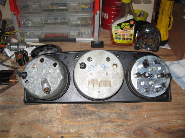

Examine the rear of the gauge and you should notice 3 or 4 small flat head screws. These hold the gauge mechanism in place. CAREFULLY remove the mechanism by loosening the screws, and set the mechanism aside.

Great idea and it works very well, I used the 5m orange el wire, it fit in the gauges just fine and can't be seen. I used a 3 way pigtail coming off the inverter and its just a quick disconnect to plug or unplug the gauges.
I'm including a pic of the gauges lite up, the picture doesn't do the lighted gauges any justice. The gauges came out great very happy with the results and it was an easy job. Thanks for the thread on how this is done.
