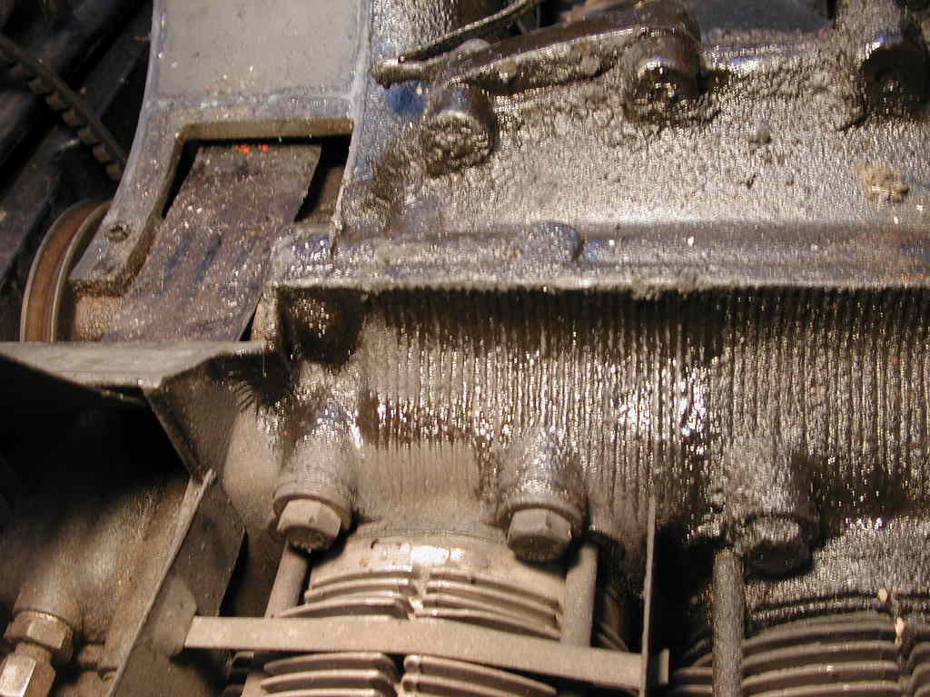

The first is what appears to be an oil leak on the top of the engine. The front two bolts on top of the case appear to have reasonably fresh oil on them. (It's not completely fresh, and the engine hasn't run for any length of time in a couple of months, so it's a little hard to say) The pic from the drivers side shows the top two bolts, and on to the case just above the cylinders.
It may be nothing (there was an oil leak on top of the engine a while ago as one of the oil lines was not tight enough) but I got'sta ask.
