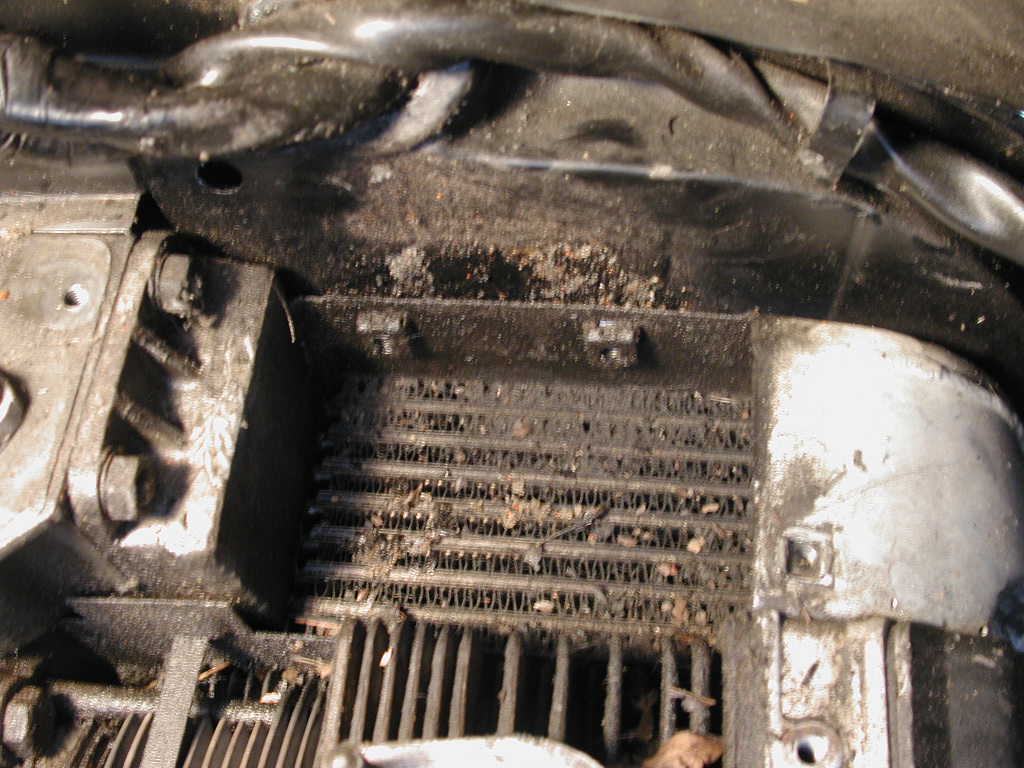

The next thing I can see is that there is crap on the top of the oil cooler. Now, on the morrow, I intend to mess with my shopvac and see what sort of clean up I can affect. But I was wondering if there are other things I could/should be doing to clean this guy out since I can get at the top of him?
kim.

krk   The next thing I can see is that there is crap on ...   Jan 24 2004, 06:56 PM
Gint   Nice work Kim. Anybody make 911 engine shrouds? ...   Jan 24 2004, 08:12 PM
J P Stein   OK, so what is the question? It appears that you...   Jan 24 2004, 08:20 PM
seanery   911 Engine shrouds? AIR makes a CF one.   Jan 24 2004, 08:48 PM
krk   JP: great point on the shopvac/fume issue. I...   Jan 24 2004, 08:50 PM
Gint   Put some plastic under it. Brake cleaner will eva...   Jan 24 2004, 08:53 PM

krk   And you thought this thread was dead. Shame on you...   Mar 16 2004, 08:57 PM
krk   Nother before.   Mar 16 2004, 08:58 PM
krk   My cleaning approach: First I used a shop vac with...   Mar 16 2004, 09:02 PM
krk   Oops. The Pic!!!!!!! :...   Mar 16 2004, 09:03 PM
krk   And finally, for the really perverse -- you need t...   Mar 16 2004, 09:05 PM
