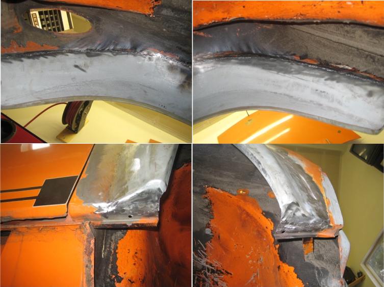

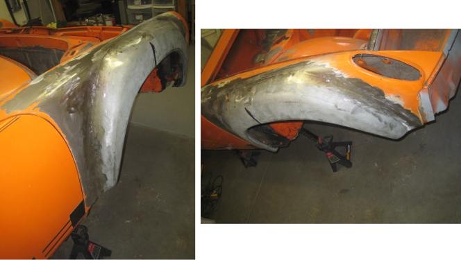

I am finished (or hope I am) welding on the 1st flare, posting mainly to see if there is anything I am not doing correctly so I do no propogate my mistakes onto the next one.
At this moment in time my next step with this flare is to add some filler, this is what I plan on using for the first step.
Filler Step One
