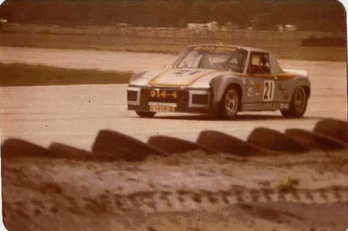

Competing at Sebring as a 4-cylinder (changed to a six soon after).
