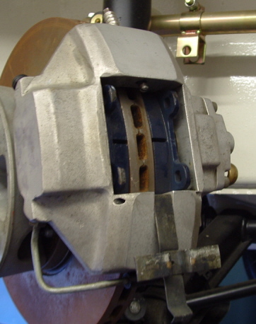

sixnotfour   I was thinking these would be cool on your car.   Mar 1 2009, 09:55 PM
carr914   Damn, what are those off, a Boeing 747? And John,...   Mar 2 2009, 07:35 AM
sixnotfour   They were actually sold for 911's. 3 1/2 spac...   Mar 2 2009, 09:52 PM
FourBlades   Those are some beefy looking calipers. Can you te...   Mar 2 2009, 10:03 PM
sixnotfour   :wacko: BTW ralph m and company has the mold for...   Mar 2 2009, 10:37 PM
FourBlades   Do you mean front caliper or bumper? I don't ...   Mar 3 2009, 07:25 AM
sixnotfour   Do you mean front caliper or bumper? I don't...   Mar 3 2009, 09:33 AM
ChicagoPete   Doesn't Bernie Buschen have some 908 calipers ...   Mar 3 2009, 06:21 PM
sixnotfour   http://www.roadglue.com/forum/showthread.php?t=521   Mar 3 2009, 09:02 PM
krazykonrad   :drooley: :drooley: :drooley: :drooley: !...   Mar 3 2009, 09:50 PM
FourBlades   I have seen Bernie's thread on 908 calipers. ...   Mar 4 2009, 08:10 AM

FourBlades   A picture Eric sent me today of the 908 repro cali...   Mar 6 2010, 04:48 PM
gms   A picture Eric sent me today of the 908 repro cal...   Mar 7 2010, 10:03 PM
