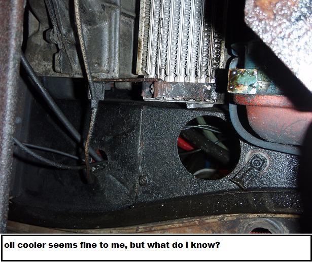

take a look guys, by the way I did get her home the other night, and i beat the snow.

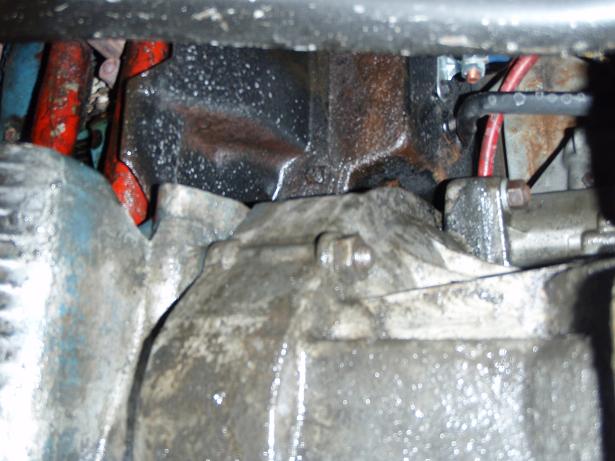

last ones

yeahmag   Been a while since I had FI on the car. Could you ...   Mar 3 2009, 06:51 PM
jsayre914   Could you tell if it was coming from one of the b...   Mar 3 2009, 09:22 PM
Jake Raby   Tons of blow by... Either the rings are shot or th...   Mar 3 2009, 06:54 PM

yeahmag   When combustion gases go flying past the rings the...   Mar 3 2009, 07:21 PM
Jake Raby   Bad rings can create blowby as they allow gases to...   Mar 3 2009, 07:28 PM
jsayre914   Bad rings can create blowby as they allow gases t...   Mar 3 2009, 09:24 PM
r_towle   Bad rings can create blowby as they allow gases ...   Mar 3 2009, 09:33 PM
Dr Evil   So, when are we going to rebuild your engine :) :i...   Mar 3 2009, 07:54 PM
wertygrog   My engine does the same thing when a hose falls of...   Mar 3 2009, 08:06 PM
Vacca Rabite   Hey Joe, I'm not in class this week. Next we...   Mar 3 2009, 08:10 PM
championgt1   How did your engine run before this mess? The stac...   Mar 3 2009, 08:15 PM

jsayre914   anyone know where this came from??   Mar 3 2009, 09:33 PM
r_towle   oh, the oil is from your Head vent hoses and the l...   Mar 3 2009, 09:34 PM
