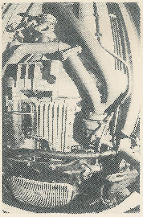

Attached ImageThis was a customer's 928 single turbo/ water meth injection "Special order" that we built circa 1979. We set the boost to 6 psi, it ran like a raped ape, and shipped the car. The customer was aware that the engine was not built for anything but normal aspiration...but explored the variable boost control and higher boost limits. I figured that by the fully clockwise position of the boost valve, he must have killed the engine at 25 psi of boost. It had 100 % leakage in all 8, and some of the ring shrapnel was buried in the aluminum block.
