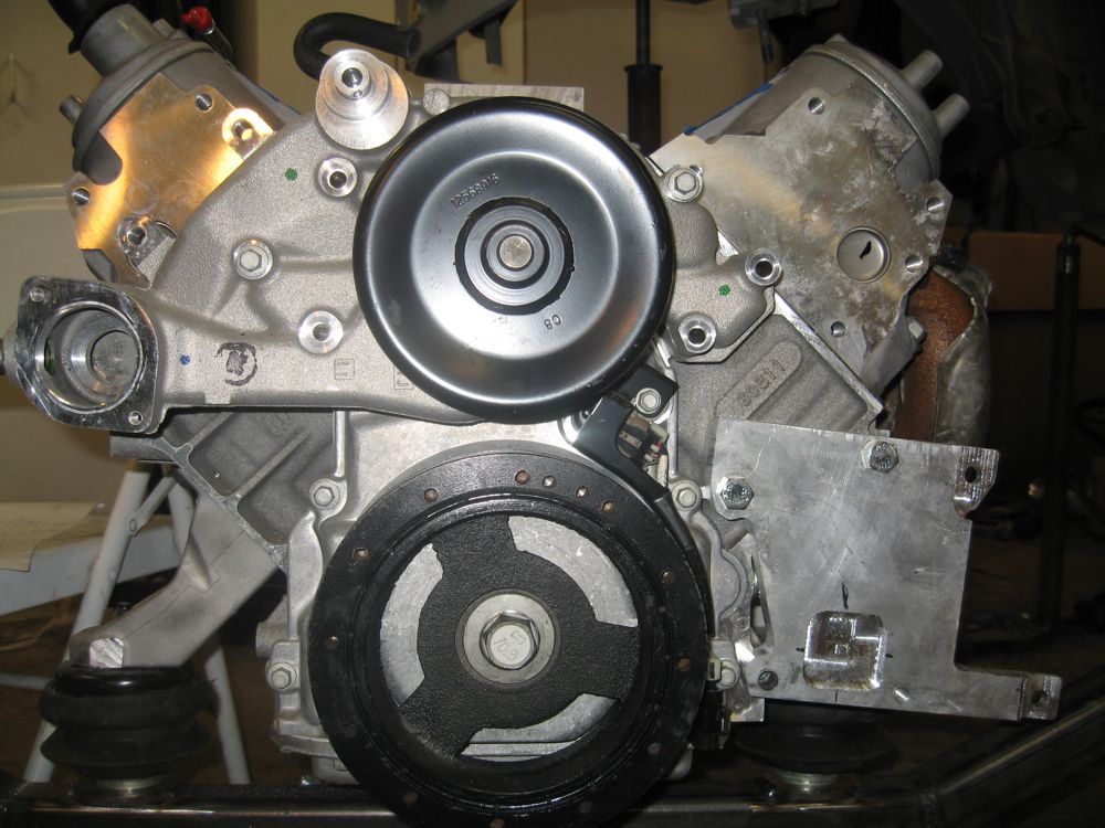

Finally figured out a bracket to hold the alternator. Here is the aluminum chunk:

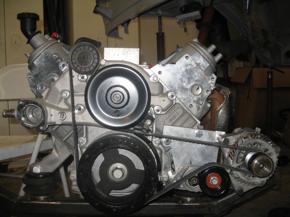

Alternator, guide pulley, tensioner and belt installed. To allow room for everything and tuck stuff into the firewall center bumpout, anything that is high, must be centered, ie water pump and idler pulley. Anything that is low, can be wide, ie alternator and tensioner,

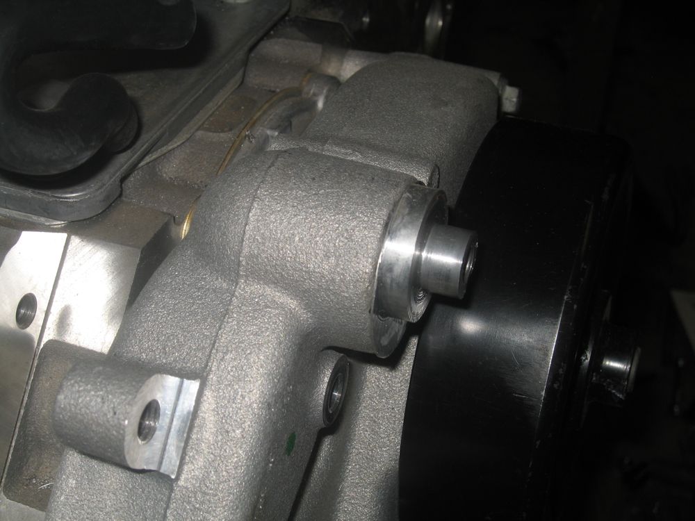

Machined a plug for the water pump outlet that does double duty. It seals this hole and is the bracket for the upper idler. Will need to drill the water pump for a water outlet in a better spot.
