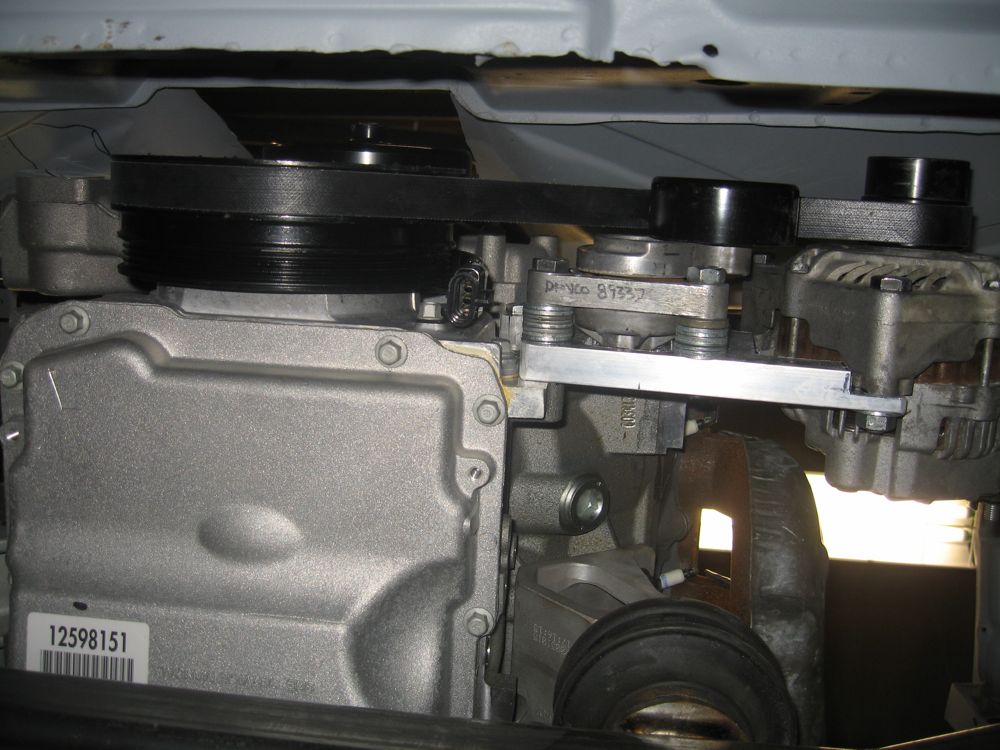

Here the bracket on the motor viewed from underneath:

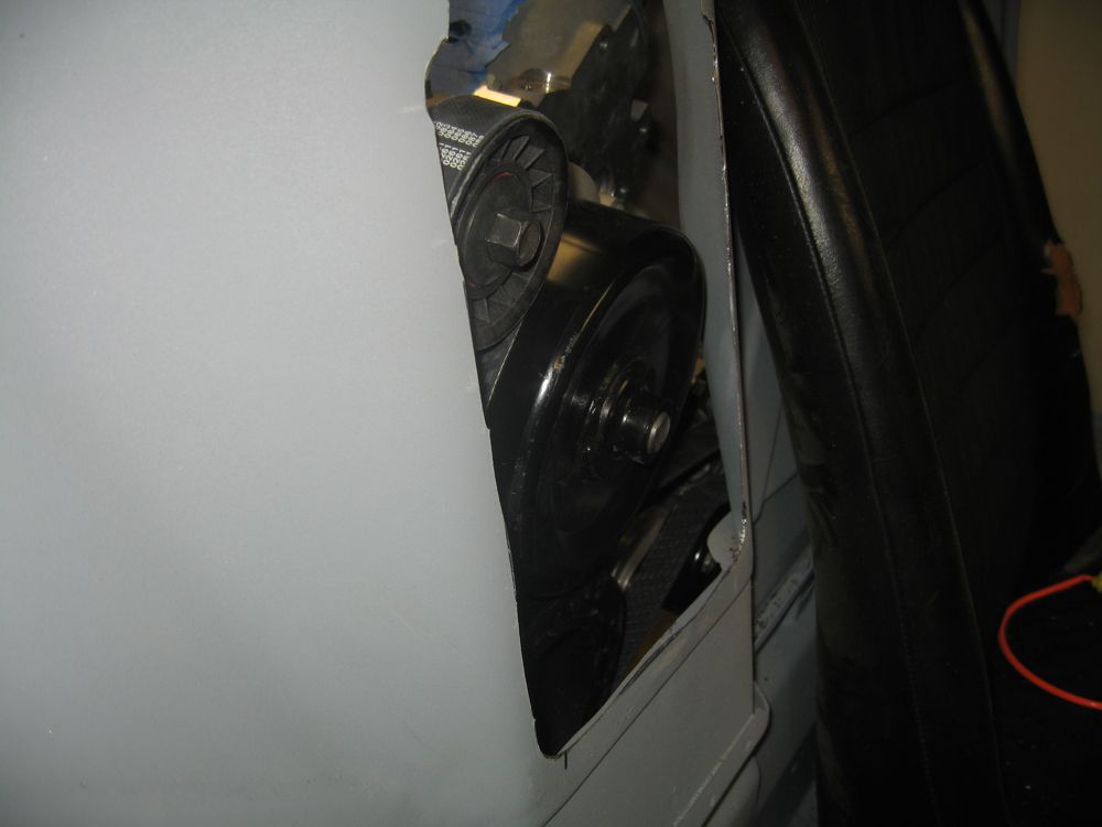

Here is a view from inside the cabin, passenger side, at about 45 degrees:

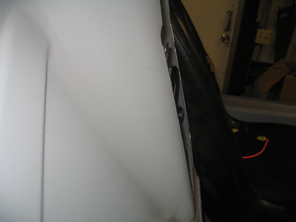

This is an extreme side view of the above shot. If I had moved the engine back another quarter inch, I would not have had to cut the firewall.

Wilhelm   Little more work done this weekend: Finally figur...   Mar 14 2009, 03:42 PM
Wilhelm   Here the bracket on the motor viewed from undernea...   Mar 14 2009, 03:46 PM
kwales   That .25 inch makes the belt replacement doable......   Mar 14 2009, 03:51 PM
3d914   Very nice work! Who's engine bar and moto...   Mar 14 2009, 05:39 PM
Wilhelm   Hope to never have to change the belt. I got 132...   Mar 14 2009, 07:47 PM
