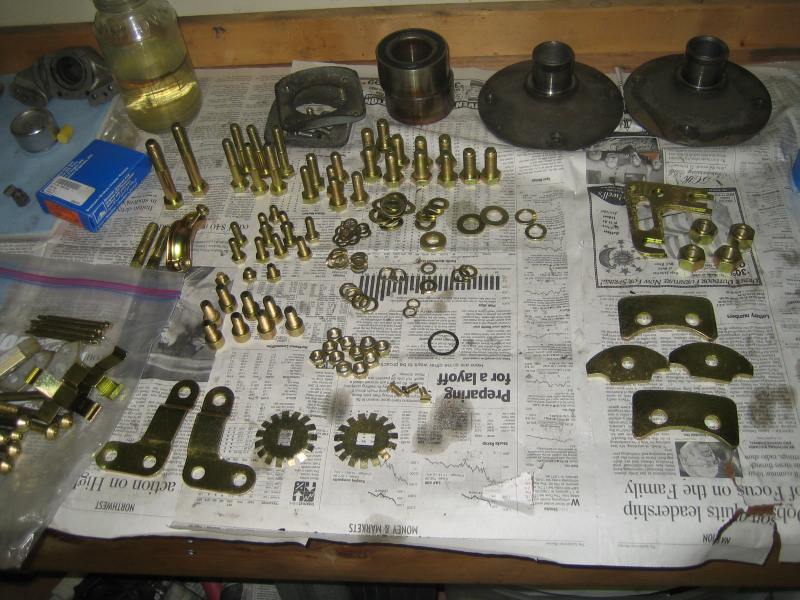

Got some parts plated, calipers came out crap so are on their way to Eric.

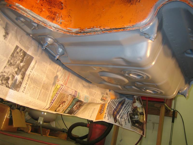

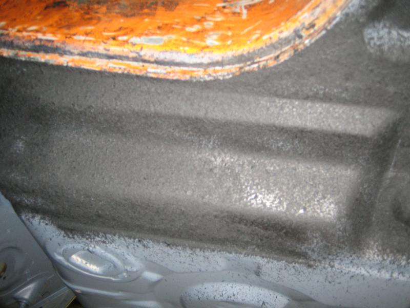

Finally decided it was time to unpack the spray gun and all of the associated gear and give it a go. I bought the DeVilbiss Finishline 3 for primer use with the cup liner kit for easy clean up. Epoxy sprayed on great, two wet coats as advertised, jsut did under the front trunk to get the feel.
Funny every time you do something on the car you always go one step too far, should have quit with the Epoxy while I was ahead. Got out the 3M Schutz and applicator gun and thought this would be the easy bit ... noooo. This stuff is messy, it is up there with CV grease IMO. Anyway I tried a patch and it came out way to rough a finish, no change in pressure had an effect and then I realized it is probably gravity working against me as this is supposed to be sprayed horizontal with the applicator gun. I am thinking I should have bought the cans.

my928s4   Went back to the local paint and supply shop and p...   Mar 20 2009, 07:08 AM
my928s4   After the failed experiment with the Schutz I boug...   Mar 20 2009, 07:12 AM
