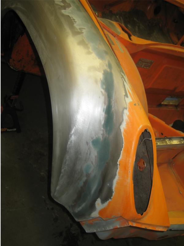

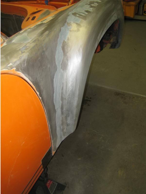

Went back to the local paint and supply shop and picked up some filler as well as some rattle can underseal.
I think this filler is a little overkill but the idea is to seal up the weld and then cover with normal filler. For that step I am going to wait and perform that operation outside, good excuse to catch somes sun (we actually saw 50F yesterday) and the dust stays outside.
Also making enquiries to see if I can get someone to come around and soda blast the rest of the bodywork that I have not gotten too.
This is the filler I used:
Here are the results
