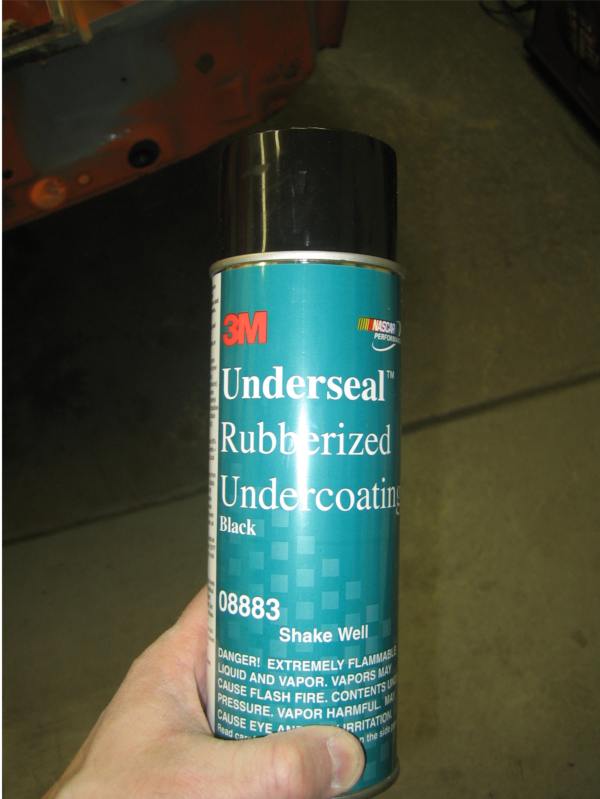

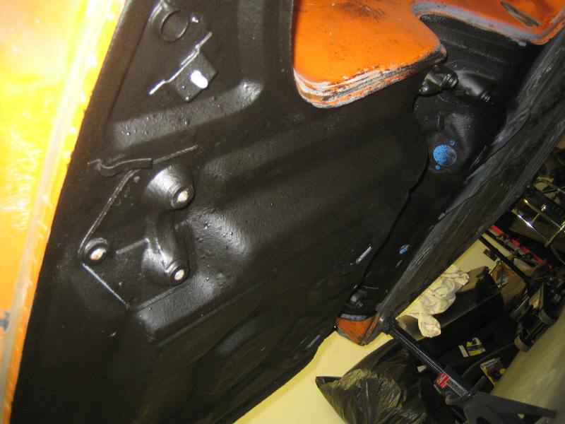

After the failed experiment with the Schutz I bought some 3M underseal, they did not have Schutz in a can and evidently this is nearly the same stuff ...
Well it went on much better but still a messy operation. I covered the floor in plastic and the key is to spray it on lightly in multilple coats, you could do it in one session but that means crawling over the mess on the floor so 3 evenings worked better.
