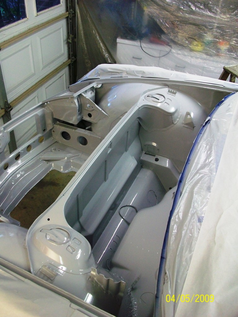

dakotaewing   More progress...   Apr 5 2009, 08:22 PM
dakotaewing   After...   Apr 5 2009, 08:23 PM
dakotaewing   I was trying to figure out how I could continue pa...   Apr 5 2009, 08:29 PM
dakotaewing   Then for my exhaust, I was going to do the reverse...   Apr 5 2009, 08:33 PM

3d914   That looks awesome. I'm curious about the pri...   Apr 5 2009, 11:39 PM
dakotaewing   I am using SPI's Epoxy primer... Regular build...   Apr 6 2009, 07:21 AM
