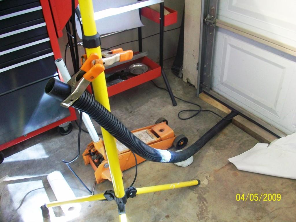

I was trying to figure out how I could continue painting, and deal with the issues of needing fresh air, and exhausting the fumes....
This is what I came up with today -
It actually worked OK...
Here is my fresh air...
I took a shop vac with a filter, reversed the hose, and put the shop vac on the outside of the garage door. I ran a couple of 2x4's under the door with the hose coming in under the door, through a gap, between 2 boards on the floor...

dakotaewing   Then for my exhaust, I was going to do the reverse...   Apr 5 2009, 08:33 PM
