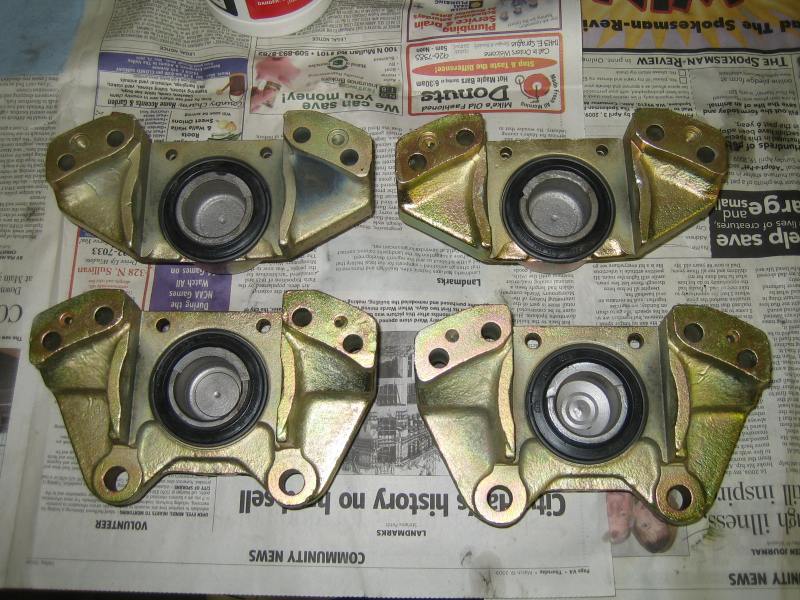

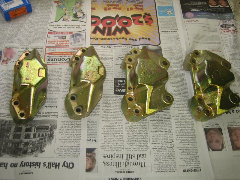

I have been receiving boxes of goodies though, the re-plated calipers from Eric looked great and they also came with new rear bearings and 5 lug rear hubs. I am picking some more parts up from the powder coaters next week so I can start putting the rear arm back together.
Couple of pics of the front calipers, once I have some of the small seals I can put the halves back together. Still waiting on rebuild kit for the rears but they look just as good.

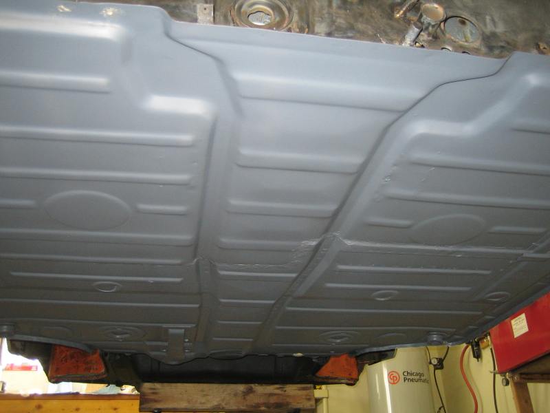

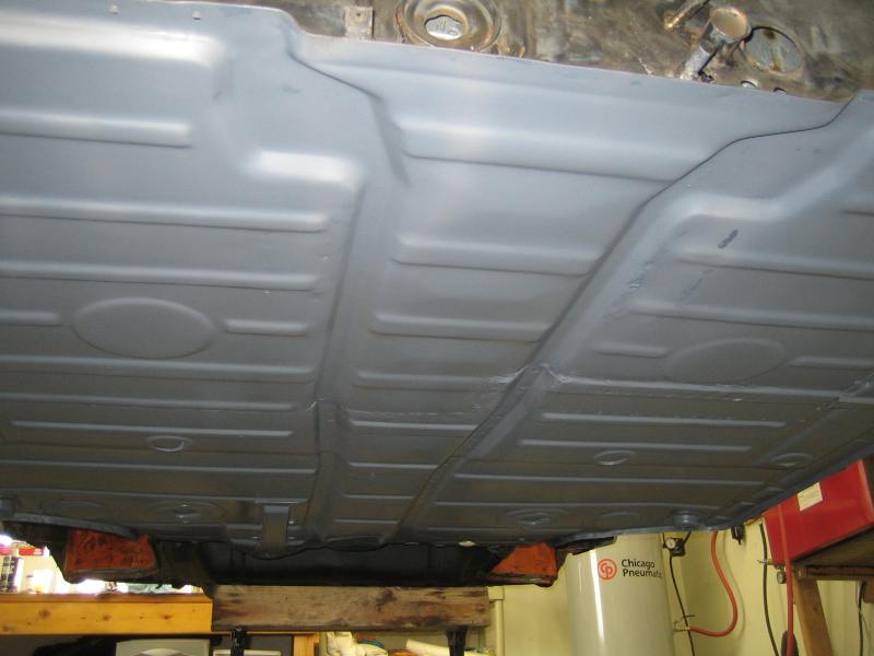

This weekend I finished the priming more of the underside.

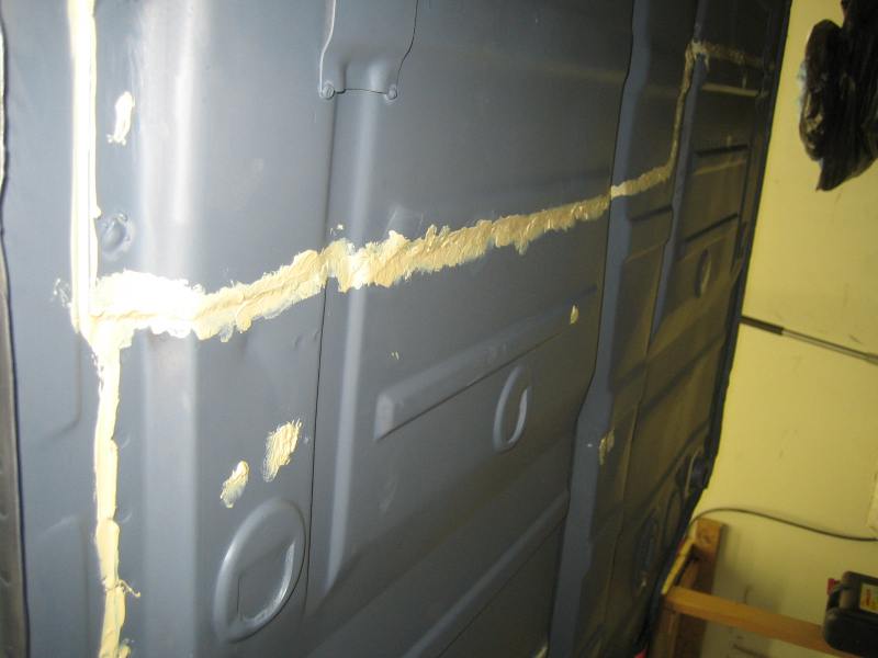

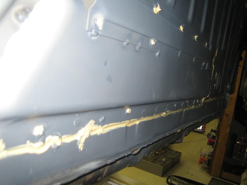

1st coat epoxy primer
Then apply seam sealer
And add a second coat of Epoxy
Now ready for underseal.
