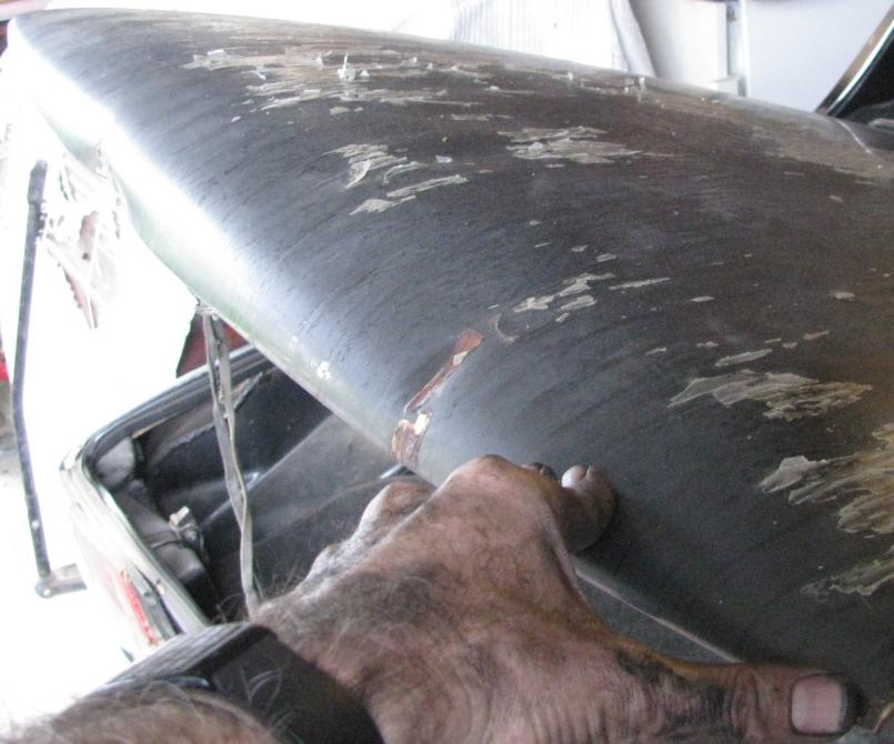

Although it has/had sway bars & Bilstein struts, chrome bumbers & sail vinyl from the App. & Perf. Group pkgs. - it was missing the center console/gauges & fog lights, & Fuchs alloys when I bought it in `76 - instead it was sold with brushed aluminum Riviera mag wheels (I would have chosen the polished Fuchs or Rivieras if new). So it begs the question as to how original it really was when I purchased it? - i.e: did the prior owners remove the center console & fog lights (& maybe Fuchs wheels), or had they been vandalized/stolen & not replaced prior to its sale to me (which the COA should tell)? In any case - after checking out several earlier & lesser quality/condition potential 914's to purchase - my mechanic Hans Imports in Huntington Beach felt it was a strong car in `76 (he's Porsche factory trained on the 914's & still in HB), so I bought it and he's serviced it ever since (see summary at end).

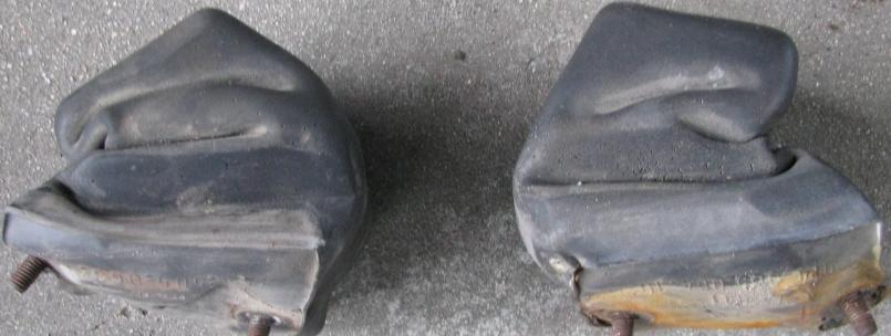

Engine mounts, clutch cable tunnel reinf., fuel pump reloc. to front (ala `75-76 914s), battery tray "clean-up" & factory recall cover & pad (batts. never leaked/corroded due to my exclusive use of closed cell batteries), new Konis up front (from orig. Bilsteins), remanuf'd. EFI computer, clutch & throw-out bearings, CV joints, rear deck/trunk lid hinges, etc., & regular maint. per factory schedule while in use 3/76-12/85 (probably during 11/72-2/76 too, while under factory warranty).

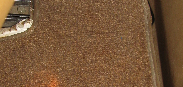

Has less common "Cinnamon" (tan) Interior & matching Tan factory loop carpet

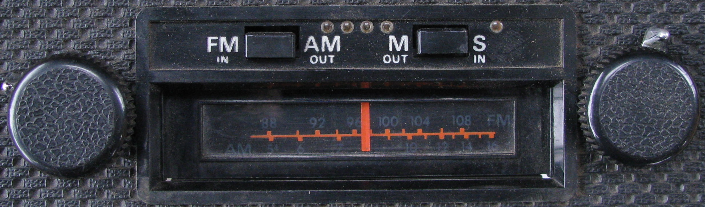

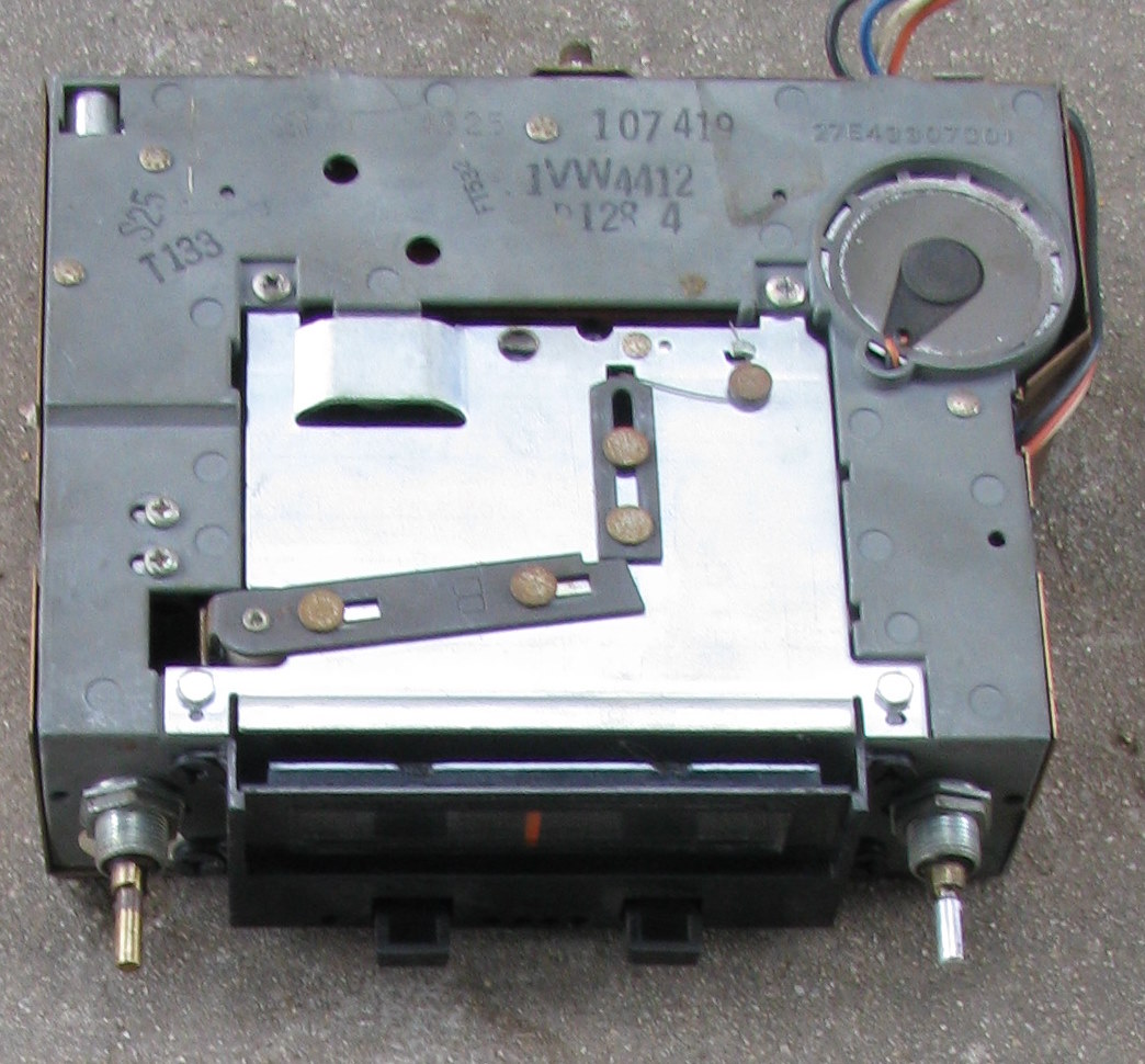

Still has early-`70's Radio/8-Track when I purch. car 2-3/76 (orig.? - don't recall brand)

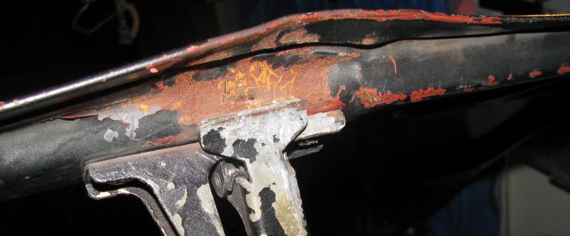

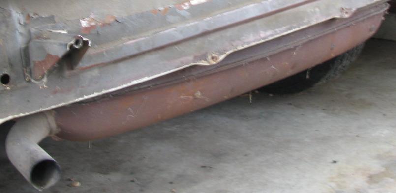

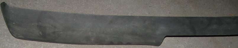

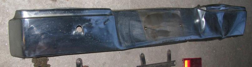

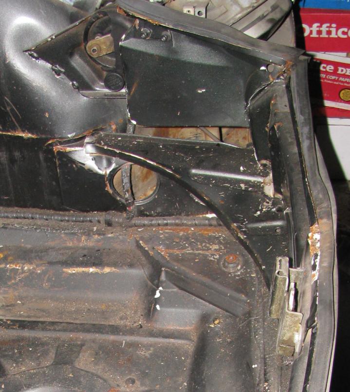

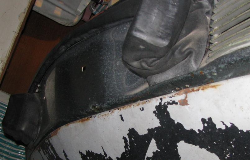

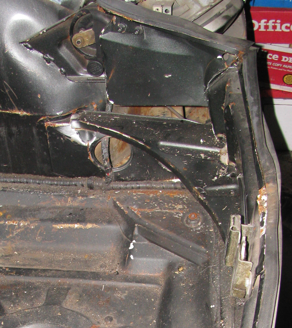

Current Condition & Repair/Restoration Needed:

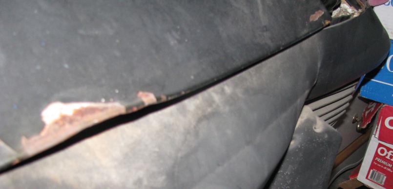

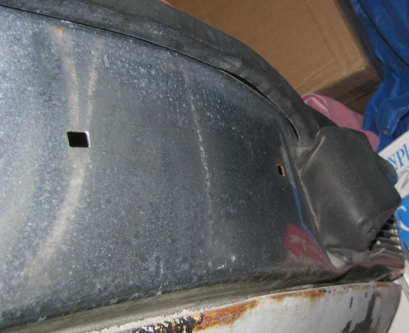

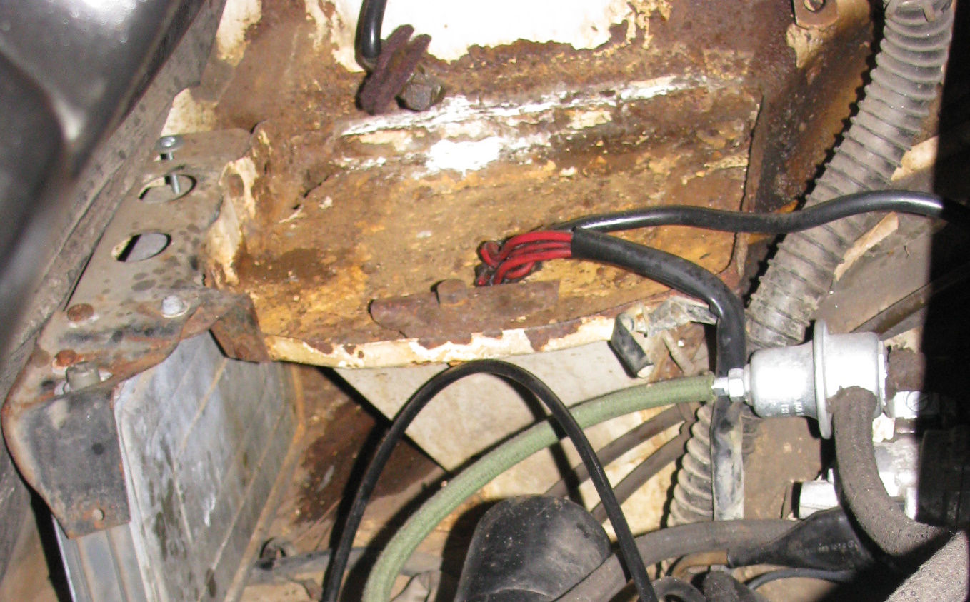

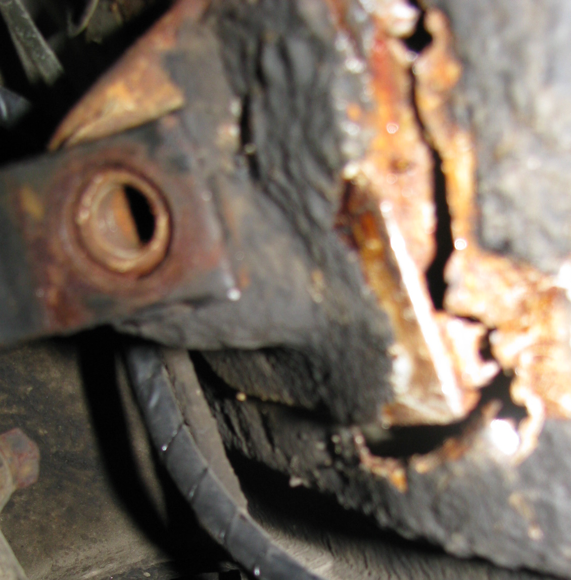

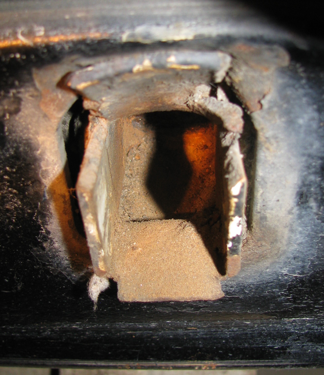

Curr. gneral cond.: has some small recurrent 1/4-3/8" rust bubbles on L/R cowl & at L/R sails-3/4 panels, some surface rusting on exposed underbody & engine compartment area (non-battery related), 2-3" tear to outside seat bolster on drivers seat (happens in every car I own!), worn older int. carpet at L&R floorpan areas (despite keeping Coco & Carpet mats 3/76-5/85), Last 1980 paint/resto job is "dead" with clear-coat failure/checking & needs repaint, & at 29+ years with age related deterioration - most/all rubber & other seals need replacement.

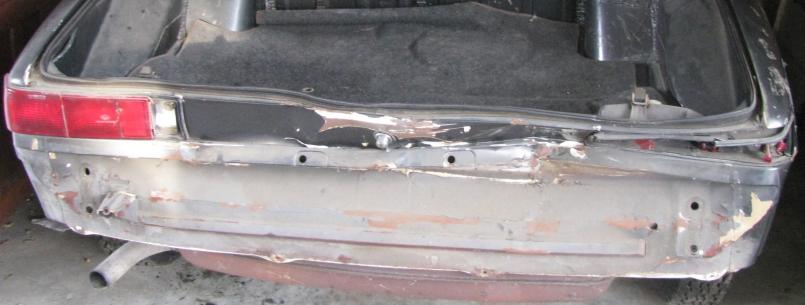

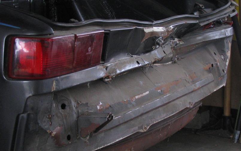

Last Accident curr. body damage due to 3rd Party hitting it in Pkg. Structure at UCLA 5/85 & pushed car front-end into conc. column, with front & rear end "damage to" items including:
(some parts may be repairable/restorable &/or replacable with "dead engine" or "roller" 914 body)

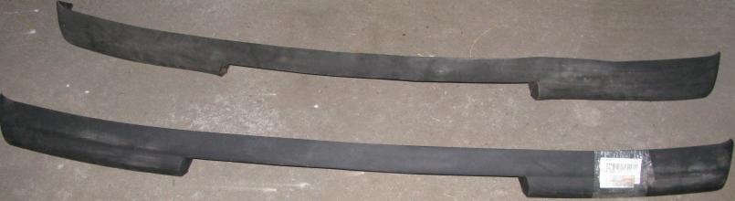

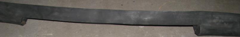

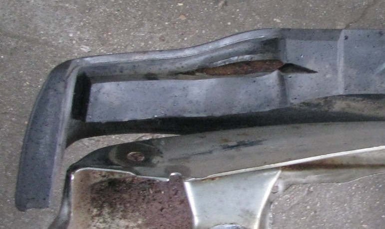

> Rear End: rear center body panel full width, back edge of rear trunk floor, lower fascia/valance (short), chrome rear bumper/faceplate & rubber bumper top/cap, L&R rear light clusters & lenses, rear deck/trunk lid, upper & lower latch mechanisms

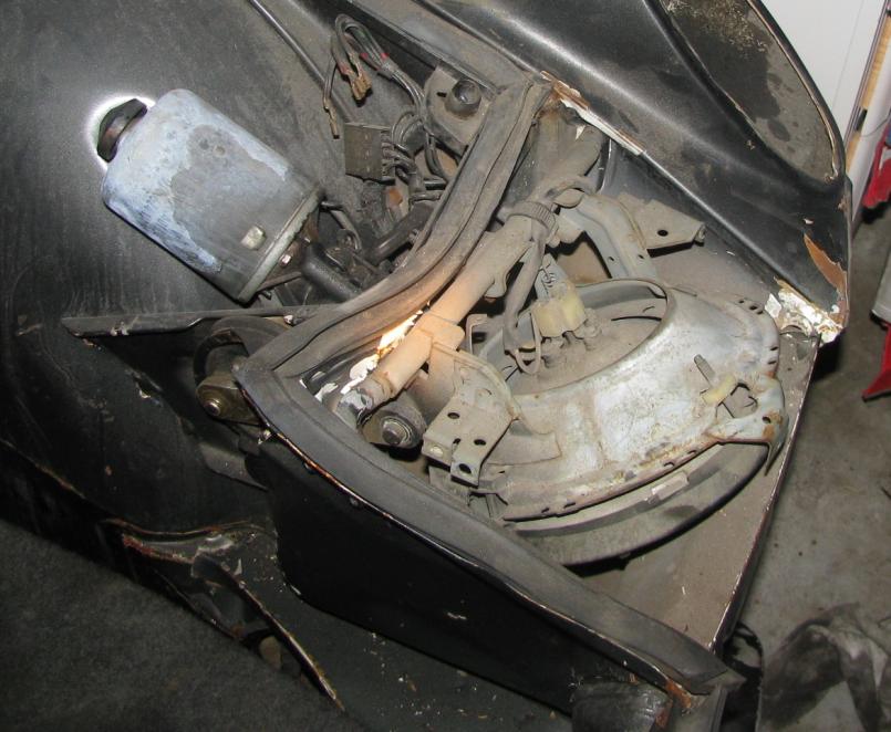

> Front End: front center body panel, left fender-1/4 panel, left retractable headlight assy. (bent axle), lower fascia/valance (stock - not dam), chrome front bumper/faceplate & rubber bumper top/cap, Left `73/74 rubber bumber extension, front deck lid, upper & lower latch mechanisms
> Uni-Body / Suspension: check & adjust/straighten Uni-body as req'd., verify suspension cond. & repair/replace as necessary (will need to replace 29 yr old Bilsteins/Konis with 4 stock Bilsteins)
> Engine & Running Gear: Although stored with Engine & Transaxle Rebuilds at only 29k & 26k miles on them, it will need a thorough "going through" of all mechanicals to bring all systems up to safe & reliable running condition. If an engine rebuild is now required after a full check-out, then I may do it as stock 2.0L, or as a "built-up" 2.0-2.5L custom engine.

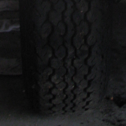

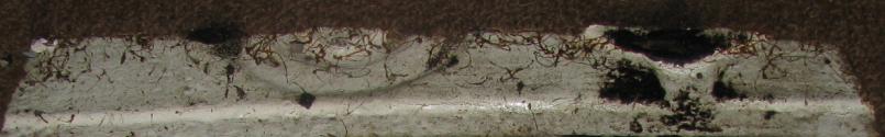

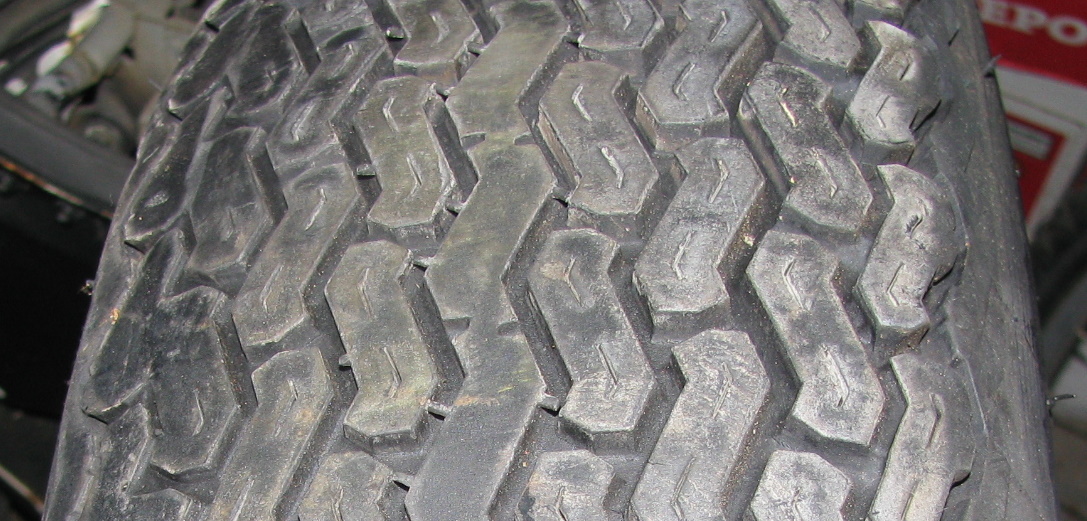

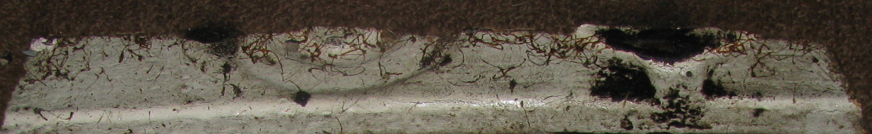

SEMPERIT "SST" "V1" 165HR15 OE SPARE TREAD PROD 2-1973 i THINK
...A REPLACEMENT TIRE, BUT I THINK IT WAS THE FIRST OEM TOO
....IT'S MOUNTED ON THE SILVER PAINTED PRESSED STEEL 5.5J X 15 WHEEL WITH THE "NEW MAG LOOK" CROSS DESIGN TO THE STAMPING
1983 KLEBER (MICHELIN SUSIDIARY) 165HR15 STEEL RADIALS - LAST / CURRENT TIRES ON RIVIERA MAGS AT 4 WHEELS - STILL GOOD TREAD BUT WELL PAST THEIR "SAFE LIFE" !!!!
