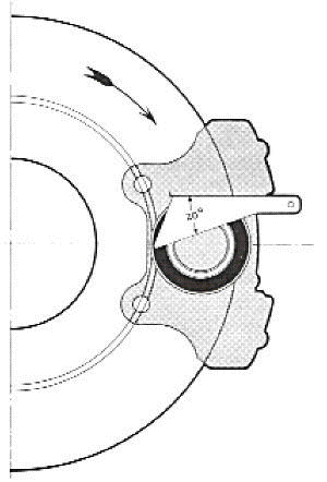

You might want to check out a caliper rebuild thread. Your pistons are not positioned in the correct orientation. The missing part of the piston rim faces the incoming part of the rotor when it is mounted on it's proper side. 20 degrees is the term they use when positioning each individual side. Wes V has a good thread and I'm sure there are others.
You are correct, found this pic on Pelican.
