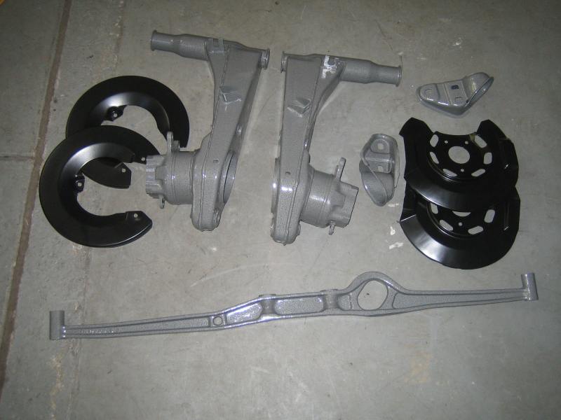

Thanks, inspired by brilliance or madness (IMG:style_emoticons/default/biggrin.gif) I do have to wonder at times.
Anyway got these back from the powder coaters today, they did an excellent job. I had the brake protective plate done in black rather than plated like OEM, I am not after originality and the plating does not seem to hold up well on this part.
