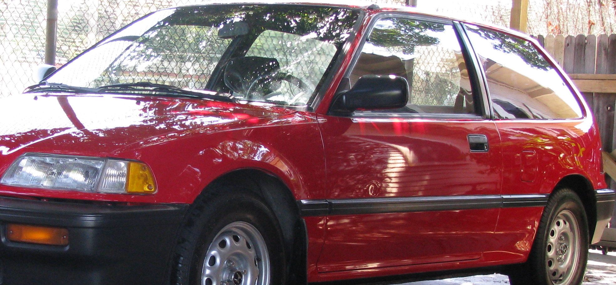

BTW - I'm only going to do some of the more basic bodywork, rust work & maybe stripping & POR15 & priming, then turn it & the parts/parts car to the Paint & Body, Bumper/Re-chrome & unibody rack pro's! I can do maybe all but the F&R damage, & bottom & battery stand rust items - unless my buddy still has his welder - in which case we could take on the latter 2 items also.
I've done some less serious body work than the F&R above. A couple of weeks ago we finished up an inherited 88 Honda Civic for my kids use, doing minor chips, dings & rust areas, plus leading & bondo-ing the LF fender damage at the pic below. We got it to primer stage, then took it to MAACO for a quick urethane paint job, which we hope will last the kids 4-8+ years. That was a "practice car" for the 914 by my son & myself. (IMG:style_emoticons/default/smash.gif) (IMG:style_emoticons/default/sawzall-smiley.gif) (IMG:style_emoticons/default/welder.gif)
`88 HONDA CIVIC HATCHBACK "PRACTICE CAR" FOR MY UPCOMING `73 914-2.0 PROJECT
completed April `09 (IMG:style_emoticons/default/smile.gif) next...... (IMG:style_emoticons/default/wacko.gif)
