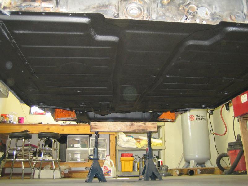

At last the lowest part of the car is done, the 2nd and 3rd can of underseal worked waaay better than the 1st, much easier to apply. Two coats and about 1.5 cans to do the floor pan.

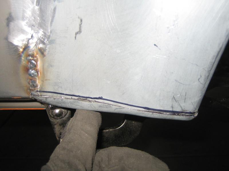

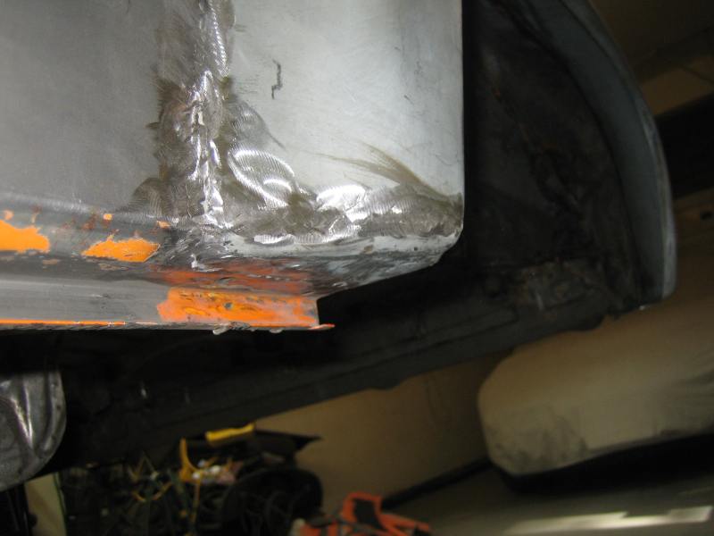

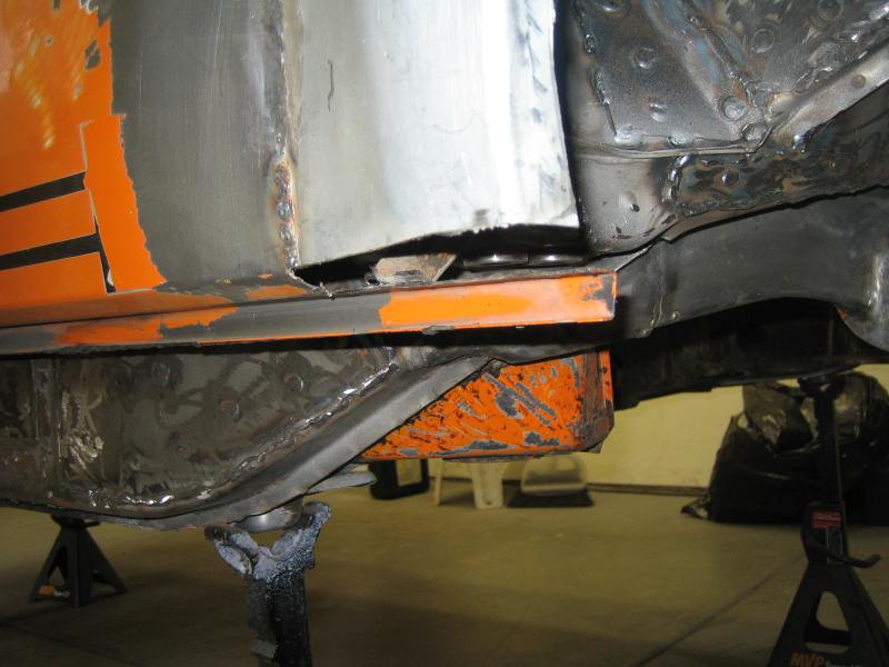

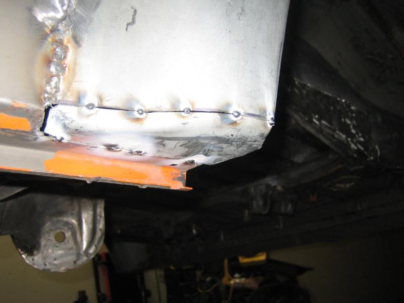

I added the following because someone posted and asked if this happened to others, you do your best to align everything but when you get to the finishing the bottom of the flare it doesn't align quite right. In total this happened to me twice and is no doubt because I did not pay enough care and attention and I am a novice.
So the bottom was hanging maybe 3mm or so too low, first thing to do is cut off the bottom edge.
Align up the removed part to the remanents of the old fender (i.e the bottom), draw line and remove sliver of material.
Make adjustments where needed and get the part to fit as good as possible, tack into place.
Complete welds and grind/finish.
