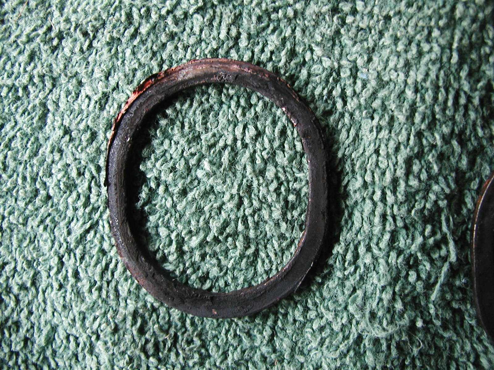

When one of my valve seats did that, it was deformed enough that I had essentially zero compression on that cylinder.
I'm still thinking it's an exhaust leak or something similar, not an internal engine problem.

Pulled the HEs today (This could get addictive). It looks like theres blow by on 1,3,4. The studs seemed to be tight but the copper gaskets are black. Could this amount of leakage cause the valve lash to sound so loud?
