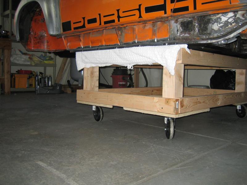

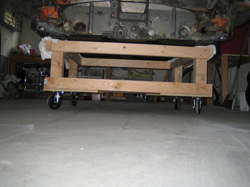

Not too much going on but took some parts to the platers and cleaned up the garage a bit. I wanted to make the body movable so I could do some of the filler work outside, off to Homedepot for some wood which is not my best medium. Anyway made up a dolly which sits nicely on the finished underbody.
Seems to work OK and pretty stable, will see how it works in the coming weeks. Got a 928 track day this weekend and the wife wants me to refinish one of the bathrooms so May not going to be a stellar month for progress.
