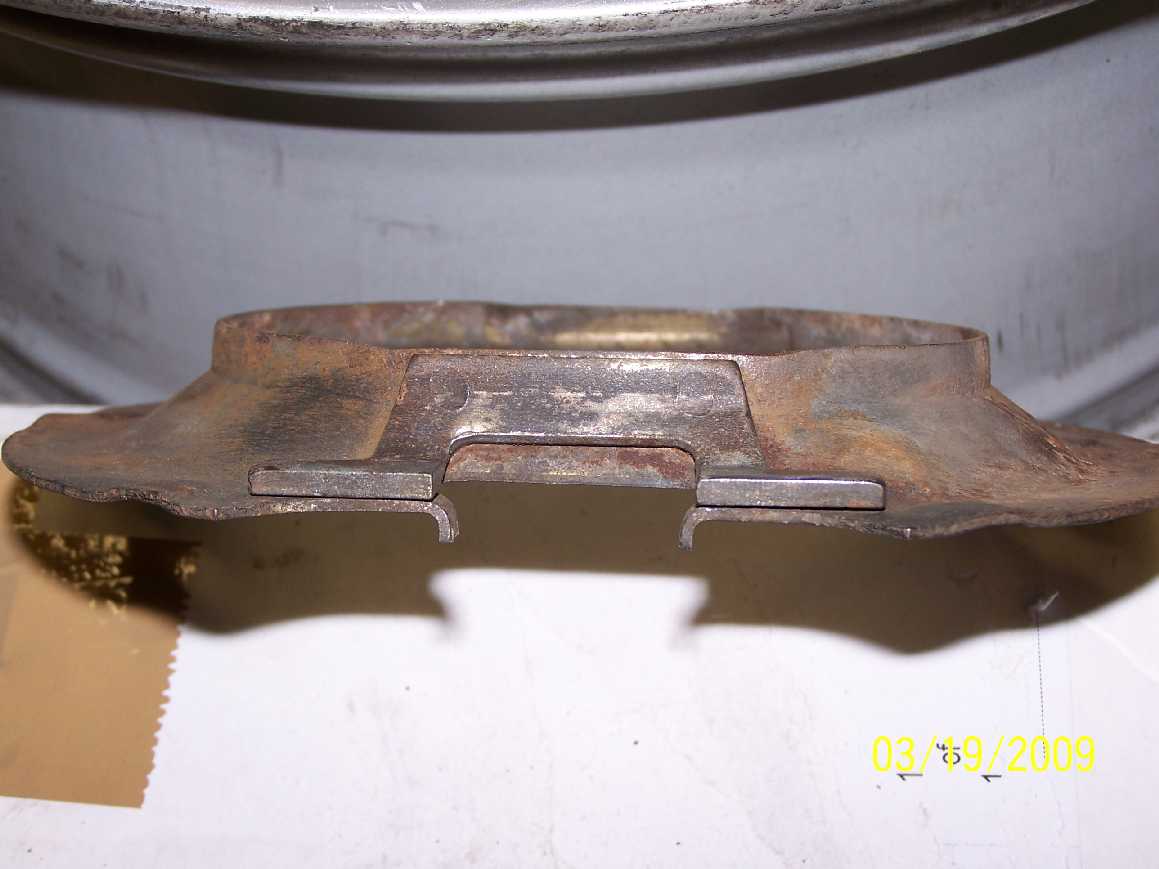

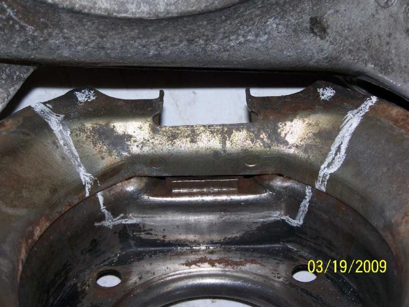

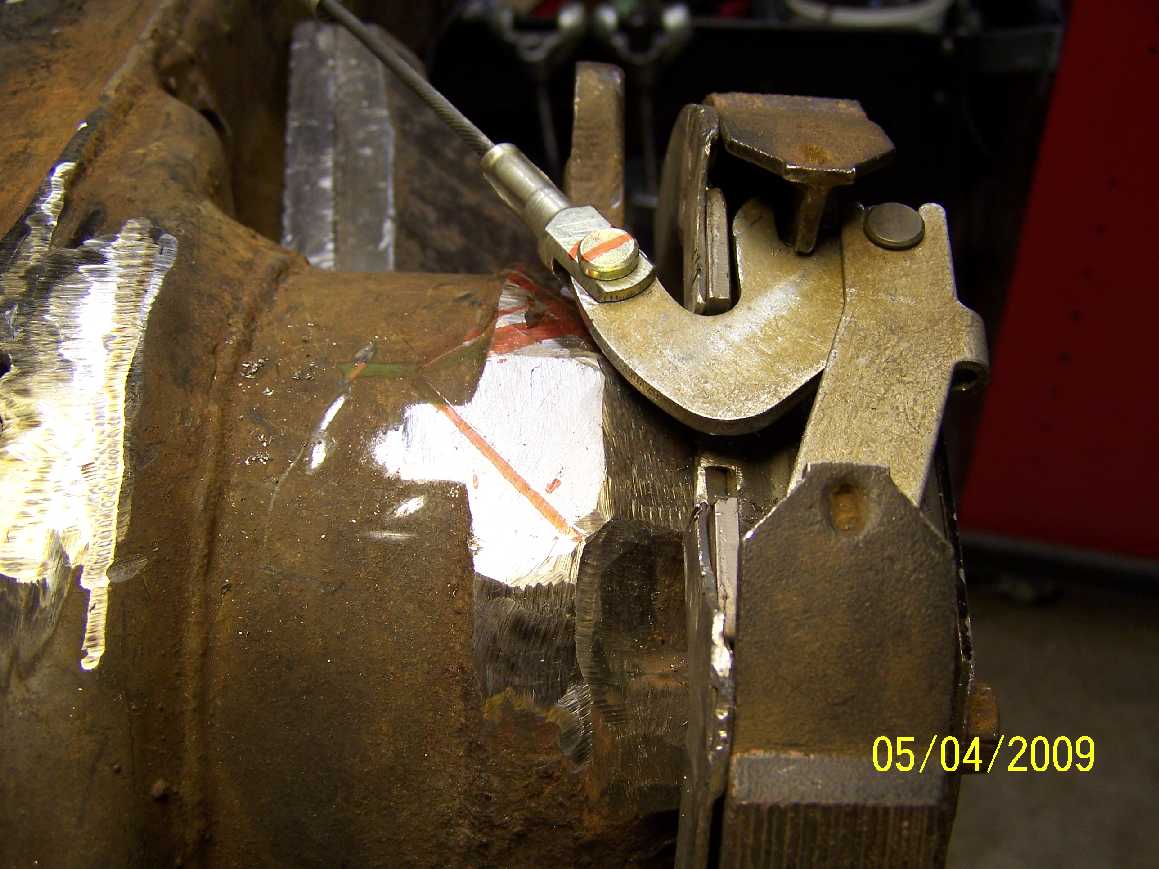

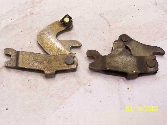

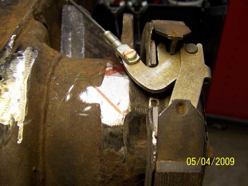

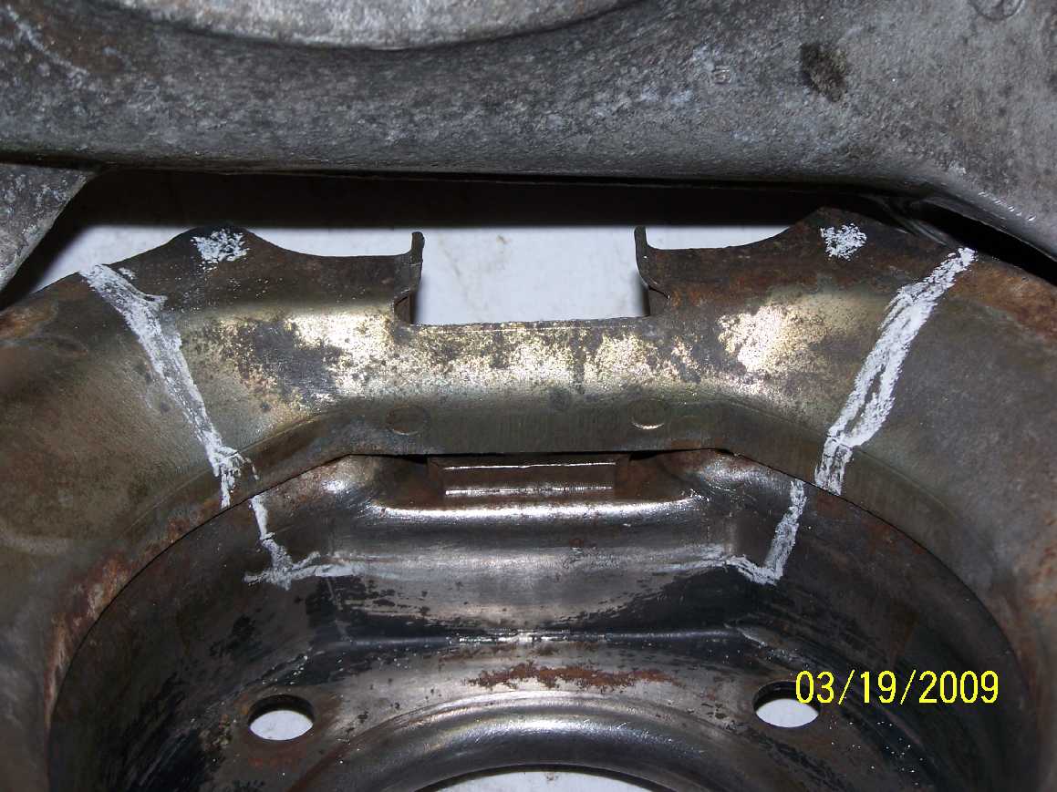

Attached ImageAttached ImageAttached Image[attachmentid=179
184]Attached Image
Top pic shows lft 944 spreader =angle pull , rgt 928 spreader slight straight/angle pull -requires a 90 deg bend in cable.
2nd pid shows 928 rear hub WITH steel shoe liner.
3rd pic shows liner - notice the factory welded on rubing block for the spreader.
5th pic shows where I layed the 928 liner on top of a early 911 shoe plate , marked to cut , did so , welded ( mig ) the 928 section onto the 911 section ( I am a very novice welder and this turned out Gr8 , but DA didn't take pics )
4th pic shows plate , shoes , spreader , cable mounted studing for the best angle to fab up a holder for the cable tube to mount the cable in, and fab the shoe stop / anchor tab.
Look these over , think what you want, maybe try it yourself.
944 spreader seems to be the ticket !!
Jaxdream

jaxdream   Top pic shows lft 944 spreader =angle pull , rg...   May 25 2009, 10:23 AM
