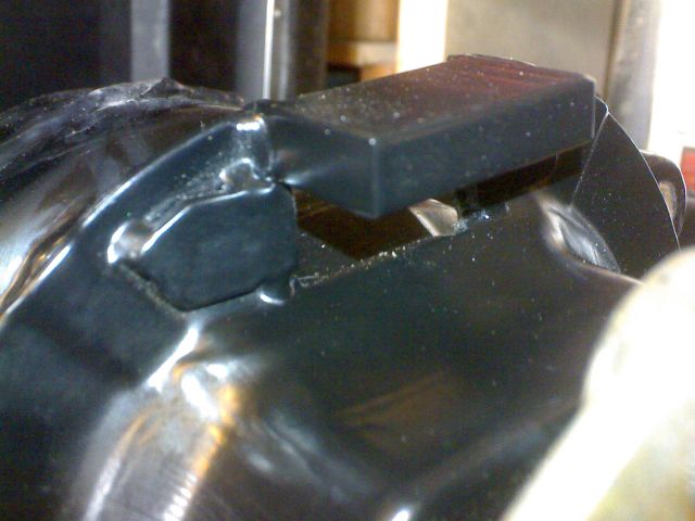

Turns out the PO installed 'rubbing pads' on the brake frame...

TonyAKAVW   Turns out the PO installed 'rubbing pads' ...   May 25 2009, 03:25 PM
