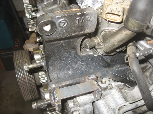

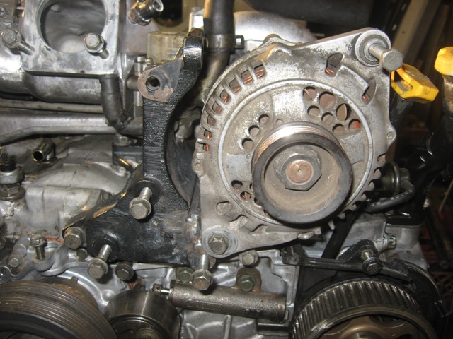

I'm reversing the intake on my EJ22T engine to permit a bit more room between the throttle body and trunk firewall. It also will permit fewer bends for the intercooler connections.
First off, the 2.0, 2.2 and early 2.5 engines feature the intake-to-head bolt holes in a line, which makes this a relatively straightforward modification. In short, the intake manifold bolts on facing backward or forward, but it ain't quite a bolt-on and walk away affair...
Reversing the intake points the throttle body right at the backside of the alternator. Since I won't be using the air conditioning compressor or power steering pump, I relocated the alternator to where the AC compressor used to sit. Here is a pic of the factory bracket, modified to clear the Idle Air Control solenoid. You can also see where I welded on the alternator mounts and support crossbar.
This took a lot of measuring, cutting, more measuring, grinding, more measuring... you get the idea. But it lines up perfectly with the crank pulley. Here is a pic of the alternator as mounted (I still have to fabricate a top mount).

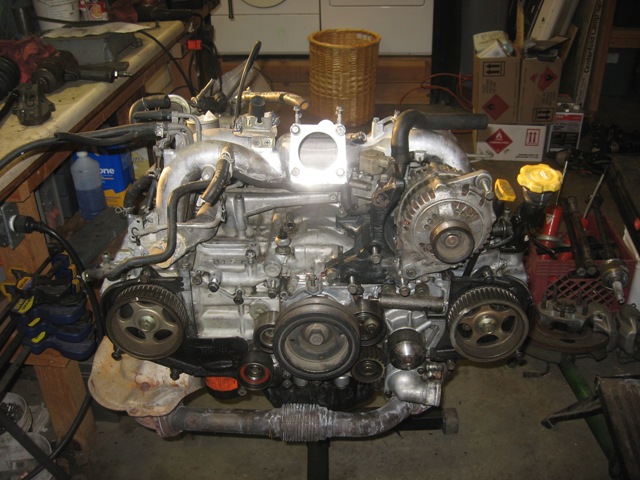

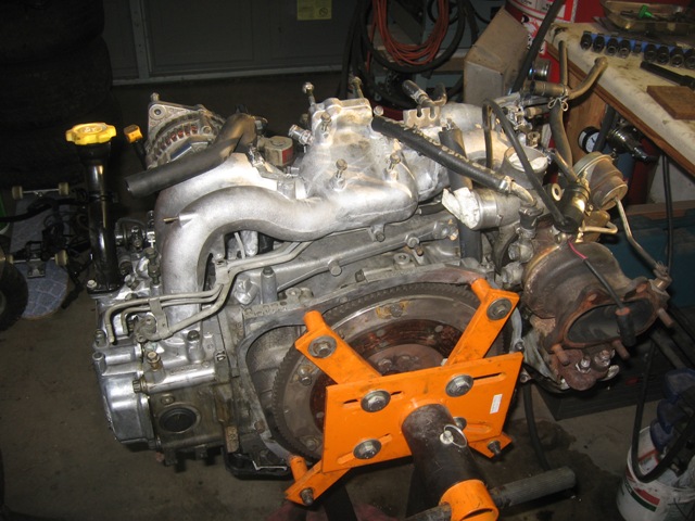

Here is the front and rear views of the engine, not including the wiring harness, coil or fuel rails/injectors.
