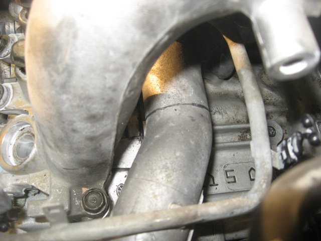

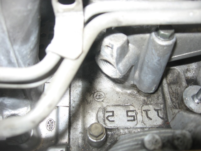

I also decided to modify the coolant crossover pipe to remove the rear water heater inlet (I'll pull hot water from near the radiator up front for cabin heat) and to move the two sensors over toward the other cylinder banks to provide clearance for the reversed intake. I probably could've bent the sensor leads down to clear the intake, but I didn't want to stress/damage the sensors. I actually started by modifying the EJ22T turbo coolant pipe by drilling/tapping holes in the factory-supplied bosses, but then realized that the normally-aspirated EJ22 coolant pipe already has the sensors in the correct position. So I picked one up at the local Pick-n-Pull for $10.
The rear water heater inlet is brazed in, so I heated it up slowly and yanked/turned it until it slid out. The hole is the PERFECT size for a 3/8" pipe plug, so I picked up a tap and brass plug from my friendly Ace hardware store. Here is a pic of the tapped hole.
The front water inlet actually bends upward a bit, which puts it relatively close to one of the fuel rail supply lines. I'm sure it would not be a problem to leave it like it is, but I like the idea of nice, cool (non-heated!) fuel. I plan to cut the pipe at its lower point to provide a bit more clearance, and to weld on a "lip" (to help secure the coolant hose). We have an aluminum MIG setup at work, so I'll try my hand at that next weekend -- lucky I now have a spare to practice on! Below you can see the Sharpie line depicting where I'll weld this lip and then cut the pipe.
