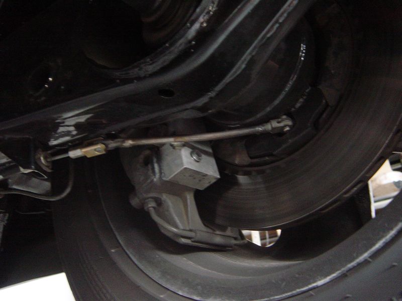

I've adapted the 944 e-brake spreader to my car and have been using it for 3 months now it it works great.

QUOTE(craig downs @ May 27 2009, 12:20 AM) *
What a "teaser" photo!!
Looks like everything was addressed. I really like it.
How about more information and photos. Please don't tell me that you fab'd up the whole thing and didn't take photos.
Wes

craig downs   I've adapted the 944 e-brake spreader to my ca...   May 27 2009, 01:20 AM
Wes V   I've adapted the 944 e-brake spreader to my c...   May 27 2009, 09:04 AM
TonyAKAVW   Craig: Nicely done! I think this is what mine...   May 27 2009, 02:36 AM
craig downs   Craig: Nicely done! I think this is what min...   May 28 2009, 12:59 AM
